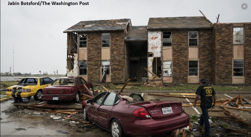

Some construction methods were revealed by the hurricane winds in Rockport Texas. Comparison of news photos with google maps shows catastrophic (and perhaps fatal if the residents didn't evacuate) damage at wood framed apartments. I"m not from this area, but if I've correctly identified these apartments, they're a block from the water's edge and stylistically look like they're from the 1980's. Veneer brick pulled off. Roof sheathing and trusses lifted. Celotex sheathing.
look at street view google maps: salt grass landing apartments rockport tx
washington post (scroll down to 'photos') article link

I'm not seeing the photos in question.
Looking on Google maps, it looks like that whole area would have gotten wiped clean by storm surge, though.

Some of what I was talking about now starts at 34 of 74. They added many more photos.

for some clarity, this is one of the photos I linked to initially. Other photos at the linked page have been replaced as the natural disaster continues.

Looks like that Celotex is doing its job. We don't need no stinking plywood or roof diaphragm!
