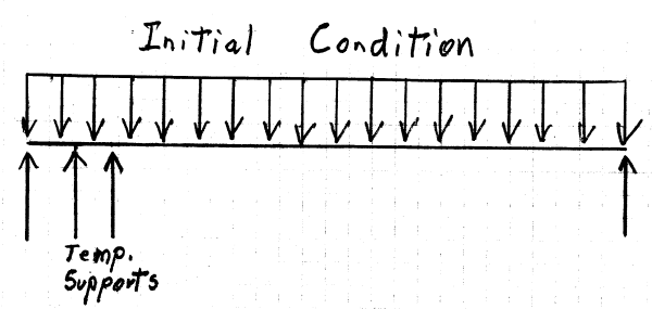

My questions is - each scaffold prop is 75% utilised in compression based on each prop taking 25% of the total imposed load in the propping. However, my manager said that the inside props will actually take far more load than the outside props by virtue of them being closer to the span. To clarify - he said that the inside props will support 3m of bridge length and the outside leg (closest to cut line) will support 0.7m of bridge length.
I understand why he has said this but because the props are so close together (400mm) will they not share the load equally?

Temporaryworks - I see several problems with the proposed plan. Number One is the relatively high loading (75% of allowable on the props). And that value is for ideal, static, steady-state conditions, with an overly optimistic assumption (equal force in all props). Consider that the props have to be positioned and put in compression before the saw cut is made:
Will the compression force in the props be monitored?
As the saw cut is made... what happens? Does one side of the bridge "sag" (binding the saw blade), while the other side remains attached? What is the compression in the props during these dynamic conditions?
What does the Contractor do if (when) the saw blade gets "stuck"? What does his actions do the compression force in the props?
Equal force in all props is practical (for steady-state conditions)... but that is just one issue. Much stronger props should be used because of the unknown forces during demolition:

Temporaryworks - Sorry for the confusion I have caused by using the the word "sag". I am referring to bridge deflection in the third dimension (parallel to the saw cut) as the saw cut is being made. Making that saw cut will be tricky. No matter how the saw cut is done, getting the entire 6.0 meter long saw cut to release cleanly, smoothly (without some impact on the props), and simultaneously from it's existing support probably will not happen. If one of the two beams releases from the support before the other, the saw blade will become locked in the kerf.
Follow the load-path of the props. Will they be supported by a "foundation" that will not deflect under load?
Having the props only hand tight may not be a good idea. That almost guarantees the props will deflect under full load... regardless of their "foundation".
I agree with you that the longitudinal dead load deflection of the the bridge will work in your favor. If all props are (significantly) equally loaded before the saw cut is made, the equal loading on the props should (theoretically) remain unchanged after the saw cut in completed... except there are complications:
1. Before the saw cut, the bridge has simple supports at the ends of the 6.5 meter span. After the saw cut, the bridge has three supports, one at the end and two that allow part of the span to be cantilevered. Don't just "think" about it (and dismiss it), do the math (I did, after making some simplifying assumptions). Load on the support at the end of the span drops from 50% of total load to 44% + of total load. The temporary supports suddenly go from near 0% of total load to 56% + of total load. IMHO, that is a significant event.
2. Temporary construction loading (causing additional longitudinal span deflection) will be supported almost exclusively by the props with shortest (5.6 meter) span. The props with the 6.0 meter span will pick up essentially none of the construction loading.
To me, changing the (theoretical best case) loading on the props from 75% allowable to 67% allowable is trivial. The props need to be much more robust to take the sudden application of full, probably unequal, loading along with potential impact when load application takes place.

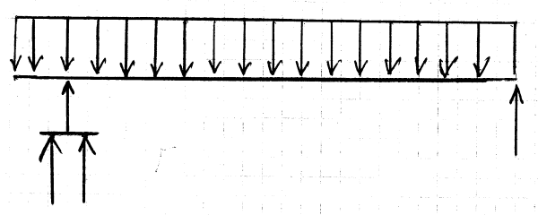

A little late to the party, but do your shoring towers allow for a cap beam to divide the load between the two towers under each beam?
The name is a long story -- just call me Lo.
RE: Temporary propping of bridge during demolition
Lomarandil, if you mean a header beam yes I could do but not sure that that would spread load effectively because it wouldn't be as stiff as the concrete beam it was supporting?
You mean because the beams would be running parallel to each other?
Place a contact/bearing plate at midspan of the cap beam (you'll have to check deflections, but I figure 1/2" is probably enough) so that the concrete beam only bears at that location. Then it's just a point load into a cap beam supported by the two towers. That's about as positive of a load distribution as you can get.
I believe my second sketch posted on September 3, shows exactly what Lo is describing. If not, I apologize for misunderstanding.
Yes, of course, that's exactly what I mean.
