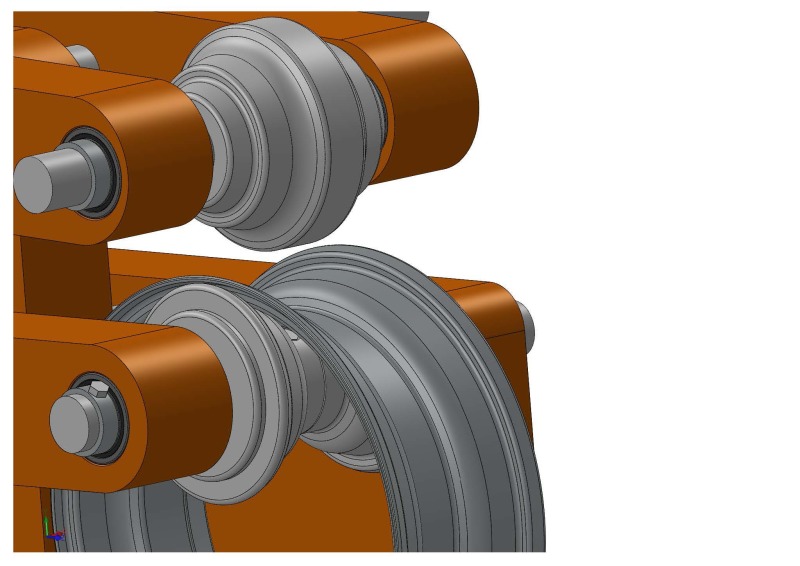

I need to calculate the forces involved on a roll bending machine and components. I could find no documents or books on this regard
Any recommendation ?
The product is a 5mm thickness steel wheel, to be formed on a single roll (male and female, profiled to the final form), gradually pushing and rotating.
The wheel is already an enclosed cylinder, welded ends. All I need is to profile it.

I'm not really visualizing the problem, but not sure it would help if I could- anyway, a sketch would be informative.
If you assume that the entire cross-section involved is at yield stress, half in tension, half in compression, you'll have an idea of the bending moment required to form it. Note that some materials don't have a maximum yield strength, so you won't get too exact regardless.
It may also help to work from an energy approach, calculating the energy required to go from initial position to final deformed configuration.

I enjoy the idea offered by many here of calculating multiple simple bending stresses. That's probably what I'll do. My only fear is that the overall shape, which is full of curves, might interfere on each individual calculations. After all, if I don't neglect the radius of the wheel itself, the bending is 3D
I also enjoyed the books, authors and researches recommended. Some do cover deformations that resemble mine's. Yet, I'm still open to more specific material, if they exist.
BTW, a book in italian serves well, yes.
Here's an image to clarify my intent:
- The lower rolls are fixed, the upper one moves and rotates
- There are no guiding rolls yet.
Yet.
- These rolls are a sketch. I am yet to define their actual diameter, once I find a material that teaches that
- The steel is some AISI 1045

Ok now that I know what you are up to,
I thought you might like to take a look at a production wheel rolling machine, they are all 4 roll machines in a gang, you will note that the roll operation is done in stages, not in one operation as your proposed machine does.

My concern is : how much circular has to be Your item ? With a shaping machine probably You will manufacture something similar to a circle but oval, so You need to do an action to rectify the circular shape and probably to rectify the section too

By berkshire's video I could count maybe two wheels per minute. Our market here absorbs 2 wheels per hour tongue. For that reason, the machine must be economical (a single pass, low production)
I can see that the rolls are much larger. Helpful video
After the calandra (don't know the name in english) delivers the "round" ring, a press will round the joint and weld the seam at the same time.
If I'm not mistaken, berkshire's video show this step on the last machine (2:15)
Only after that, the profiling
If it's not enough, I'll apply your suggestion of expanding

What I have seen may be of interest and perhaps further investigation by you. I attended a week seminar by Cleaver Brooks in Lebanon, PA back in the 80's. Their process to manufacture corrugated furnaces entailed heating (red hot), section by section, a length of tube to form the convolution of a corrugated furnace with a similar contraption to your image. One of the benefit to red hot heating was the absence of ripples that would have developed during the forming process without heat.
RE: Roll bending forces
I'm putting thoughts on heating the thing. Not only because of the ripples, but to reduce stresses and ease the bending.
