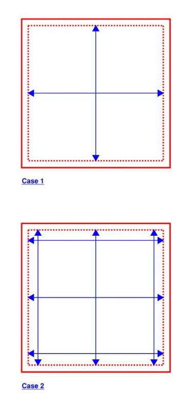

I was wanting to use RAM Concept, but didn't know how to do the design strips since there are no columns to help know what the design strip width should be. I thought about just making a bunch of 1' wide strips each direction, but didn't know if that would be correct.
RE: Two Slab Supported by 4 walls
Just run one strip in each direction. Centerline of wall to the opposite side.
If you want, run another model with three in each direction and take the worst case.

and use the same moment resistance in both directions... slab behaves isotropically for yield line... also make sure you have top reinforcing in the corners... you can develop 'corner levers and have a negative moment at 45degrees.
