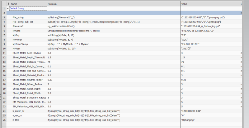

I've got my standard part file tweaked to filter the document number, revision number and description. See the image beneath. These separate info is used to fill the title block. To make the expression accurate i've to use the 'update for external change' the get te accurate info. This causing the whole assembly to update. This takes to much time.
Can this update be done without the "update for external change" ?
and can this expression update be done automaticly?

Do You wanna update date or what? I have similar problem few years ago, and in DRW file I created new attribute "DATE". It contain date from when I created those standard. When I create PDF, the journal automatically update it to time when I run this code. I have also journal to update every DWG file in folder.

I want to update line 24 to 26. These are expressions which fill my title block.

I think, that if You change part name, the expressions still rimember old value - ug_askCurrentWorkPart(). Here is the same problem described: http://www.eng-tips.com/viewthread.cfm?qid=341667
What I can advise You - instead of using expressions, use part attributes and journal to update / change.

Below is some code to create part atributes:
CODE
Option Strict Off
Imports System
Imports NXOpen
Module NXJournal
Sub Main
	Dim theSession As Session = Session.GetSession()
	Dim workPart As Part = theSession.Parts.Work
	Dim displayPart As Part = theSession.Parts.Display
	Dim markId1 As Session.UndoMarkId
	markId1 = theSession.SetUndoMark(Session.MarkVisibility.Visible, "Edit Properties")
	Dim MyTimeStamp As string
	Dim Filename as String = workpart.name
	Dim x_order_nr as String
	Dim y_rev_nr as String
	Dim Z_title as String
	Dim File_string() as String
	Dim Lw as listingwindow = theSession.ListingWindow
	'lw.open
	MyTimeStamp = System.DateTime.Now.Tostring("dd.MM.yyyy")
	'MyTimeStamp= System.DateTime.Now.Tostring("yyyy-MM-dd")
	file_string = filename.split("_")
	x_order_nr = file_string(0)
	Y_rev_nr = file_string(1)
	z_title = file_string(2)
	workPart.SetUserAttribute("MyTimeStamp", -1, MyTimeStamp, update.option.now)
	workPart.SetUserAttribute("x_order_nr", -1, x_order_nr, update.option.now)
	workPart.SetUserAttribute("Y_rev_nr", -1, Y_rev_nr, update.option.now)
	workPart.SetUserAttribute("z_title", -1, z_title, update.option.now)
	theSession.DeleteUndoMark(markId1, Nothing)
	'lw.close
End Sub
End Module

This wil help I think. When I add the save command to this yournal I can use this journal to save the file always with the latest data.
