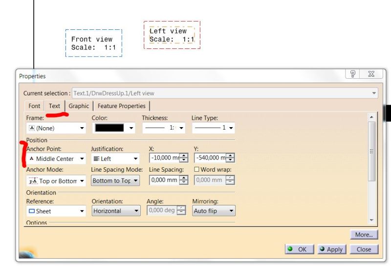

One last question: are you sure that (drawingView).x/y is a method that sets the position of the CENTER of the view? Because sometimes it seems it is not the center...
RE: Macro. Align Views on a draft
according to CHM file drawingView.x(/y) is used to position the origin of the view.
