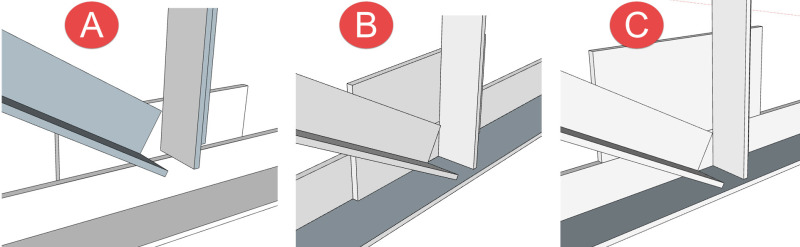

I was wondering why do we always cut the angle sections by truss connections straight?
When we would cut it parallel to the main bottom and top members then we could reduce the gusset plate size by a significant amount.
This would also lead to shorter "gaps" between the members fixing points which should be also better for the load transfer, or?
Am I overseeing something?
By wooden trusses this is usually done this way, so why not by steel?
See attached images

Well...one issue could be....it is easier to cut the diagonal member perpendicular
probably much cheaper in production

I worked for a steel joist manufacturer, cost is definitely the issue.
In a single joist there could be a ton of different angles based on different member sizings. The design cost, and setting a machine up to cut each one differently would be far more than a little extra steel on the gusset plate. Also considering that you may find that plates come in standard sizes as well, and if your design calls for a minimum of 4.5" plate, 6" might be what's in the shop. They are going to leave that extra steel on because it's cheaper than cutting it to 4.5" and that 1.5" would just become scrap needing to be disposed of.
Keep in mind, for engineers optimization always has to come back to cost, not material. In some industries, like Aerospace and Automotive those are tied together in the overall lifetime of the vehicles, fuel saving will be cheaper in a lighter vehicle, in fields like Civil Engineering, usually minimizing construction labor is more important than a little material, not always, but usually.

ok, so the one question is sorted but now I get another question.
Why am I seeing always the gusset plates outside of the member? Why don't we weld it inside? The center of gravity lines would then even line up much better
see attached image is version B and C not the best solution? and most ecconomic?
RE: steel trusses (angle sections) - gusset plate connection optimized with skew angle cut?
C is more expensive because you need to have a CJP weld between the gusset plate and the leg of the angle. Personally, prefer B over A.

Typically the point of a gusset is to be able to increase your weld length because your loads are to in your web members for the sizing of your top or bottom chords to get enough weld to safely transfer the load. With that said, your image B would be preferable, because for the proportions shown in A, you haven't really increased the amount of welding length and more than you would have just welding it to directly to the bottom chord. In image B, you have increased the available weld length, there is much more overlap between the web member and the gusset there.
@gravityandinertia: you very right but then why not version c? there you also have the increased welding area but you recuse the gusset plate.

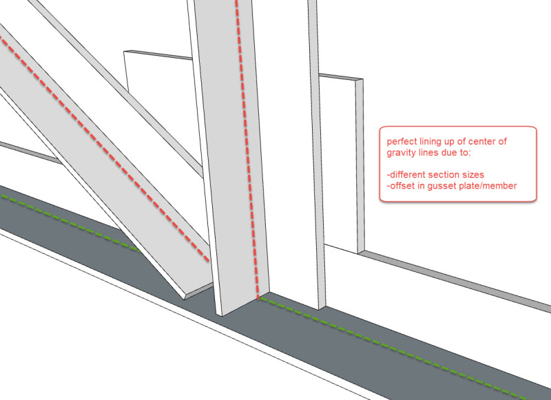

Do designers actually look into best lining up of center of gravity lines?
see image below

AS slickdeals indicated, detail C requires a CJP weld between the gusset and the bottom chord, this is a costly weld. Much more costly than the extra plate due to the prep work involved for a CJP weld. Plate is cheap.
@Jayrod: convinced winky smile thank you guys for opening up some new perspectives for me. Ok so C is out but then B shoudl be the optimum setting out when your inner sections are smaller to line up the center of gravity lines, or?
B would be my choice.

@Joyrod: Just out of curiosity, why not then VERSION "A"?
@lolobau
There are a couple more things about why B, not C as Jayrod indicated cost of the weld for one. On top of that, you can get more weld length in B on the gusset and along multiple faces which is good for redundancy, though that's sort of a tertiary benefit. The last thing would be that in B, the leg of the channel and the gusset stiffen each other more than occurs in detail C, which overall makes the joint stiffer.
Lastly, yes there is care taken in lining up centerlines, ideally all coming together at a point on the joist, in practice due to space at the connection it rarely happens.
B allows more weld length for the web members without increasing the plate size. And it looks cleaner. A is acceptable, but B is likely the way even the fabricator would want to do it.
Depending on the member sizes I doubt that C would really benefit you significantly in lining up the centrelines of each member. The slight eccentricity introduced in A and B likely shouldn't change the design significantly.
