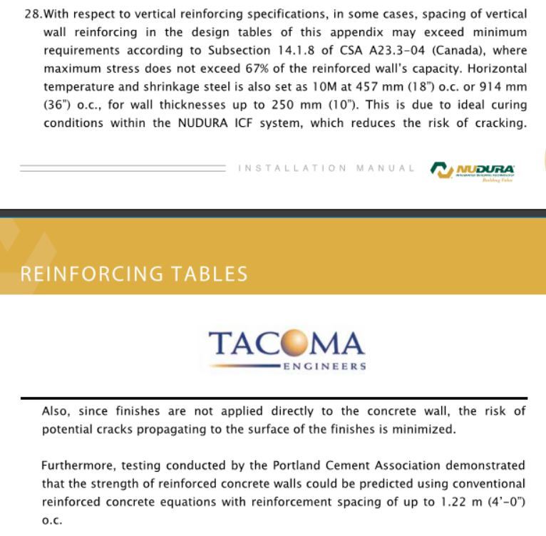

I'm curious about #4, the minimum reinforcing ratios. When those are justified through testing, what is one testing for? In all honesty, I'm not clear on exactly what the code intent is for minimum wall reinforcing. Minimum flexural capacity? Temperature and shrinkage? General integrity? It's not as though it's impossible to have plain concrete walls.

Check out the clip from the supplier catalog below. It seems that neither the horizontal nor vertical reinforcement is required to meet code minimums in their opinion.

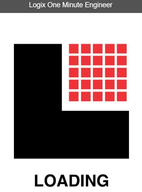

From a design wizard on another supplier's website. Hard not to find the one minute business a little insulting.
RE: Special Exceptions for Insulated Concrete Form (ICF) Walls
To play devils advocate, the foam used in the ICF project we had was really high density (it actually might have been Nudura, can't remember what the final supplier selection was now). If you stuck a large nail it in then you're not getting that nail out without taking foam with it. I wouldn't be surprised if there was some durability effect similar to poly fiber reinforced concrete, the foam bonded to the concrete should at least have some minor benefit. Also, the foam would provide an excellent vapor barrier and thus I feel that you could rationalize some reduction in minimum reinforcement if that minimum reinforcement was for durability, appearance, or environmental conditions.
Now, away from devils advocate, that one minute thing is a little silly.
