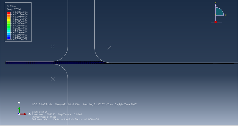

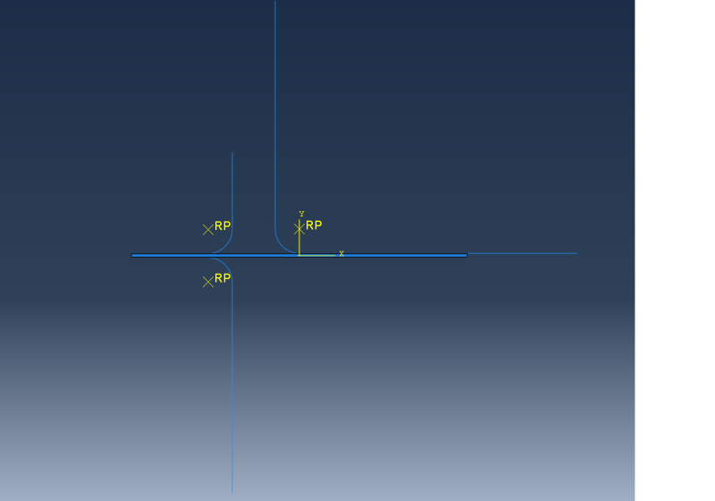

hello . I am trying to model l-shape bending of sandwich sheets in 2d plane strain mode. when I submit the job I face with this error .the punch crush the sheet except bending it
