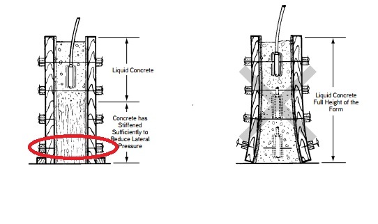

Hey, thanks for the quick answer. I just want to make a column formwork cheaper, 4 meter high (about 12') poured in two stages to control hydrostatic pressures, 40 cm max width plus both joints (16"), with a wire at midspan it is feasible to reduce wales size (spaced 16") but my concern is about the steel wire rope-joint and wire end.
I've been checking for sheave and thimbles design and bearing load becomes very large (32ksi for 1700 tension pounds) but i realise that since i'm trying to use 1/4" steel wire rope it might be comparable to nail bearing strength under Whale and Smith idealization, leaving out the considerations of surface contact that sheave and thimble roots has, I think it may be possible to take full diameter to make contact on wood.

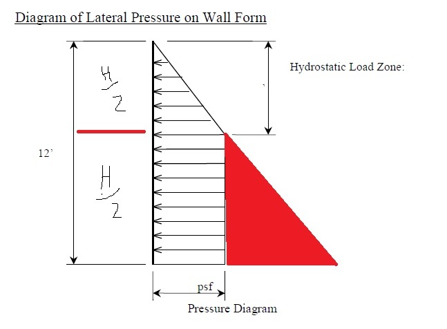

oh! i'm not trying to make a joint here, just delaying the pouring a little less than an hour, first half on each column and then repeat the sequence. Making the vibrator get inside first half about 24"-40" when finishing the second part, should I consider this as a joint?
I'm trying to get lower pressures only (second picture) and placing wires over the wales to control bending on them (red ellipse first pic).
My question is about crushing the wales with wires ropes, when reviewing sheave design to obtain bearing pressure of the rope on my wood members the result were remarkably high for my given axial tension, this is because the small diameter of the wire and the small diameter of bending i can achieve with a wale. But i don't think that those equations are valid for this materials interface and this mostly non-dynamic case. Rather i suspect that the wire rope, while being much harder than softwood, will accommodate itself and will spread the load through all contact surface in the process. Making wood behaviour more similar to Whale & Smith's nails description, but i haven't found wood bearing resistance data for steel wires to compare this idea.
