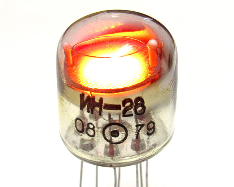

I'm tasked with designing a wacko Nixie Tube clock. I have to use the IN-28 which is a Soviet era tube that is just a single bright dot about an inch in diameter.
Here's the pertinent data sheet page:
Normally one hooks the B+ voltage to a Nixie's Anode (a metal screen) and each of the digits is a cathode that gets grounded to light it.
Well-and-fine, but this particular tube sports a Grid pin too. See pin 1 - Cetka. Cetka means 'Grid'.
Any of you tube-heads know what I should do with it? Do I ignore it?
Pins 2, 5, and 6 are NO-CONNECTION.
3 and 7 are ANODES
4 is the CATHODE
I'd be nice if anyone also knew if the diagram was viewed from below or above too. The tube is hard to see into since the sides are pretty obscured.

Are you sure it's a Nixie tube and not a VFD? The grid makes me think it's the latter...
That said, "grid" is often used to describe the anode cage

My limited knowledge of valve technology is that the grid should be biased with a potential divider to an intermediate voltage, not left floating. Bias to roughly 2/3 of the anode voltage relative to the cathode would be a guess as a starting point. Having only seen a handful of Nixie tubes in my life, I don't know if that helps much as I haven't played with them before. Interested to see how this develops. smile
RE: Nixie Tube Grid??
Dan; Definitely a Nixie tube. The rest of the data sheet states "High Brightness for Outdoor Matrix Displays". Came out before VFDs.
Scotty; Ugh. This design is already a major time consuming headache needing a 5V supply a 65V supply and a 250V supply all fed from 12Vdc. Having to add a fourth.. Shudder.
IR; That makes sense. Especially since these were used in huge stadium sized displays where often they were multiplexed. Wish someone had a circuit for them. I've searched everywhere. At this point I probably need to ignore the grid and run them the same way everyone else runs the standard ones, which have no grid.
Next hurtle is trying to mount them. I was going to mount them in pin sockets so they could be easily replaced but 50 cents a pin and each clock having 204 pins that would cost $1,632 for this build of 8.

Hi Keith,
I was thinking more of a resistor bias chain, no external supply. Might be an adjust-on-test job though, so if you're using loads of these things then it might not be viable.

This doesn't look like a Nixi (Burroughs Numerical Indicator, Experimental #1) at all. More like a gas tube with a control grid. The grid lights the dot and you will need many dots to produce a legible character. Which I think that you already know. But a Nixi - nope.
My wife reads Russian - somewhat. Are there any data sheets?
Pins are always seen from the bottom, as opposed to IC legs.

Hi Gunnar. It's definitely a Nixie Tube and certainly not the usual 10 digit kind. It's simply a dot - a big bright dot. They will be the 12 hour markers.
I attached a pdf of the data sheet.
Link
Thanks for the bottom tip. I figured it out by finding those two pins that are tied together (anodes) which quickly identified what you describe.
