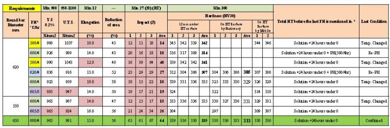

Is there anybody to have good experience about doing double aged condition of 17-4 PH round bars diameter around 500mm? same as 620C / 550C or 760C / 580C or 650C / 550C or so on?
I want to know the effect of double aging on yield and U.T.S strength and impact energy too.
Please if anybody has any experience please tell me.

I want to add my history for 3 diameters of 17-4PH round bars here.
On some of them I have done: Solution + 24hr under zero +PH
On some of them I have done: Solution + 24hr under zero +PH +PH
As you can see the results are not according to handbook or other related standard except green one for 650 mm diameter.
I mentioned my requirements to on top of the picture. as you can see my main problem is impact energy.
With this situation I am thinking about doing double non-standard PH as I mentioned in my 1st request "same as 620C / 550C or 760C / 580C or 650C / 550C or so on"
Please send your comments if any.

Why do you think that 24hr at 0 is needed?
The Mf of the is alloy is about 100F, there is no reason to go colder.
It looks like your properties are similar to those for H1050/1075.
Since your properties from that aging fall short you have two options.
Either age at higher temp, or re-anneal them and re-age.
As you re-anneal and re-age this alloy the grain size will get finer, the strength is little lower each time, and the toughness will increase.
I would try a full re-heat treatment rather than double aging. Double aging will tend to have more variable results.

Yes you are OK about 24 hrs under zero but I think it doesn't produce any damage for the parts.
- About aging at higher temp , I have done in 605C/5hrs and I am waiting for the results.
I will inform you but I am afraid of decreasing R0.2% under my requirements (min 900MPa).
- About re-annealing them and re-aging, unfortunately I can not do that because the parts were brazed in around annealing temp and I can not go again in that temp.

I have received the mechanical properties of the samples with new PH temperature (605C / 5hr).
As you can see not only we didn't receive to our impact requirements , but also we missed our R0.2% too.

If anybody knows about effect of double precipitation hardening on the above material to reach my requirements, please send his /her the comments.
I think with my received results , it seems which I have to do double PH but I don't have any experience for that. For example doing 700C/ 4hr and 600C/ 4hr or reverse .
Please send your comments or your experience results if any.
