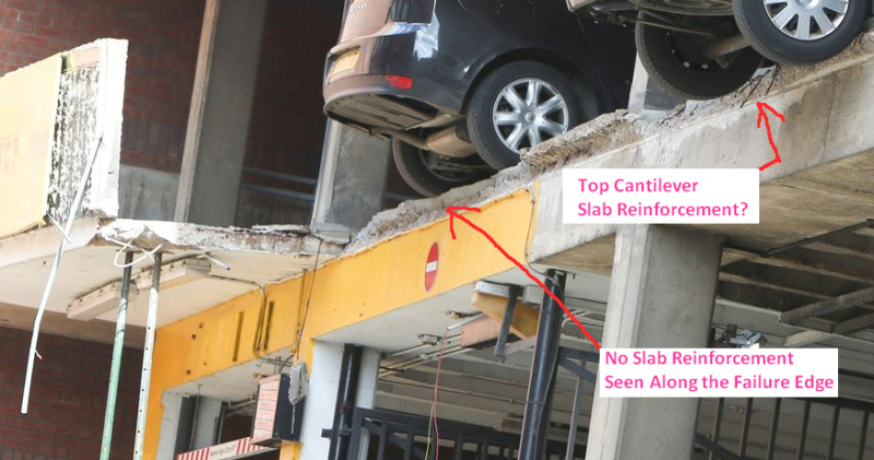

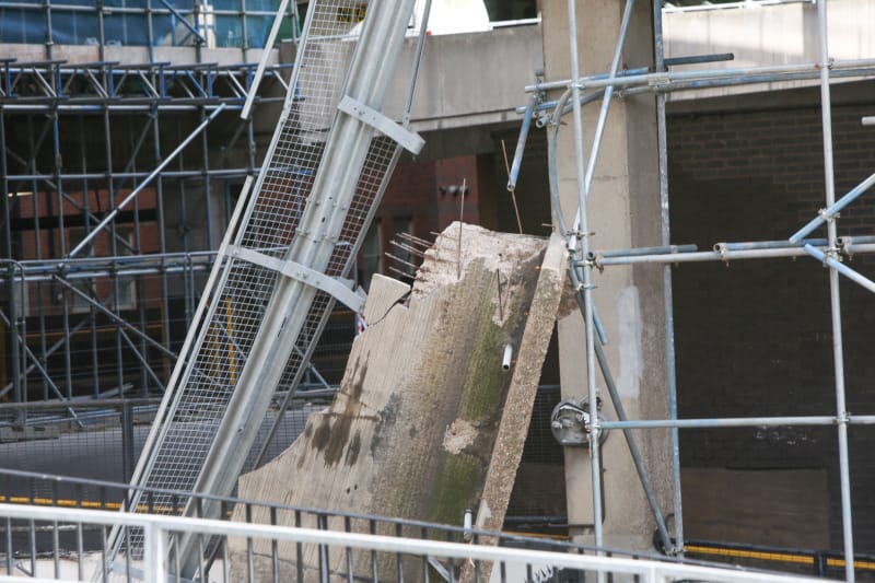

Looks like quite a clean break where the cantilever fell off. No dangling reinforcement. Maybe the bars are all corroded away. A closeup photo would be interesting.

No, it was all cast in place, and I think all at the same time. Those are concrete joists, made by using prefabricated pans as forms. The joists are tapered at the ends in the high shear area.
Past the spandrel girder in the cantilevered section, only a relatively thin slab was used, and as I pointed out above, not much reinforcement can be seen.

And no sign of any significant top slab steel to serve the cantilevered slab - unless the few bars sticking out on the right of this photo represent what was provided.
Either they were terribly detailed, installed or corroded directly off at the cantilever launch point:

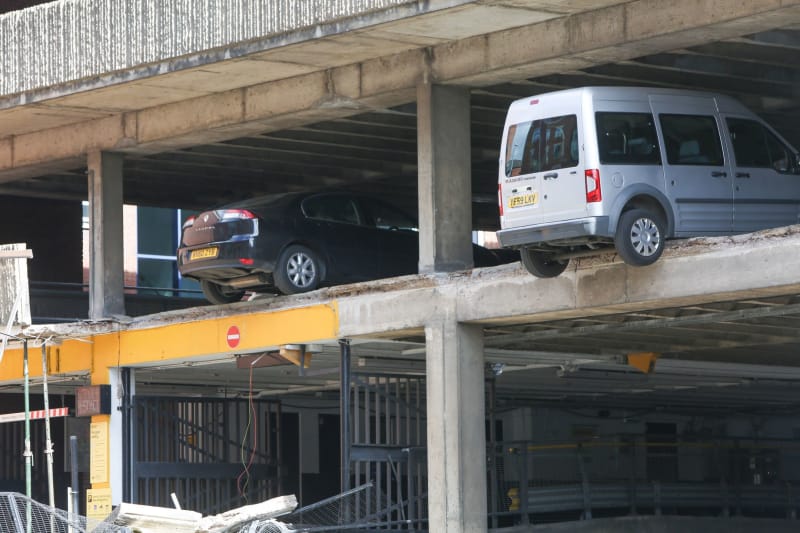

The point, I think, is that someone, even a reporter, can do essentially the same thing, i.e., measure the height of the Ford Tournedo in the image, and use that height to figure out the height above ground. Not much more than about 4th grade math to do the calculation.

If you look really closely there's evidence there that the joint between the car park and the cantilver has been repaired. The screed under the laguna ( the black car) looks quite new compared to the section around the column.

I thought the same. Plus the way it cleaved away smoothly, suggesting a topping mix with small pea gravel aggregate, compared to the coarse break of full sized aggregate used during the original concreting around the columns & elsewhere. Efflorescence suggests there may have been a full depth cracks for some time. Make me wonder if the cantilevered section was a historic low spot and bird baths pooled along the wall when it rained.
