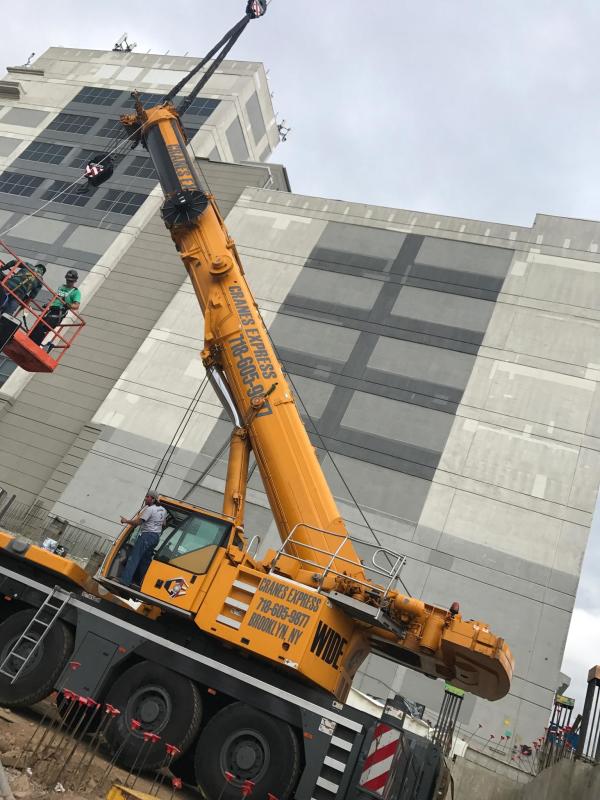

...I've never seen this happen before. I don't know the particulars, a friend sent it to me, but it happened in Brooklyn about a month ago. I assume no one was hurt because it didn't make the news.

I wonder if the way that rod buckled, forcing the cylinder to support the jib, is a deliberate graceful degradation feature or if they were just astonishingly lucky the whole thing didn't collapse.

The relief valves should have relieved before the cylinder rod buckled.

Wonder if it might be a fatigue, where the crane had been operating with a known bowed rod for possible years and it finally gave way.
I thought of this due to when I purchased a used utility tractor decades back, one of the loader bucket cylinders had a slight bow. I proceeded to replace it TILL I got the price for a John Deere part! Thus the bowed rod has been in service ever since.

It wasn't until someone mentioned bowed cylinder that I knew what to look for in the pic...

Yeah Dan! I stared at that picture for a good minute and since that cylinder so nicely conformed to the bottom of the boom didn't see it. Of course once you see it it's glaring.
