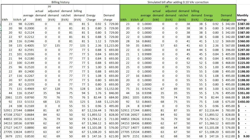

Yes, I know this is not a typical situation, which is why I am asking for any potential drawbacks for installing a capacitor on a controls transformer. Harmonic resonance and ferroresonance can be issues on utility scale capacitor banks, but I have not worked with low voltage capacitor banks before.
The application example is a pump that runs only during extreme weather events. If no extreme weather events occur, the pump is tested once per month for about 30 minutes. For a typical month:
Peak demand = 50 kW @ 0.95 pf
Monthly energy usage from load= 25 kWh + 15 kVArh
Monthly reactive energy usage from dual CPTs = 86 kVArh = 0.060 VAr * 24*30*2
Monthly average power factor = 0.27
Monthly demand adjustment= 50 kW *0.95/0.27 = 170 kVA
Monthly savings = $1088 = (170 kVA-50 kVA)* $9/kVA
In a month where the pump runs for many hours, the power factor correction capacitors attached to the terminals of motor improve average power factor to 0.95 so the demand charge is based on just 50 kVA.
@David- Yes, an alternative approach would be to consume more real power (i.e. test for longer duration or install strip heaters ) to improve power factor. I had been a bit worried about explaining this pf issue to the operations folks before posting this thread. Based on the responses so far from very knowledgeable EEs who understand pf correction, I am now terrified of trying to explain this solution the operations folks.
@Bill- Is control power transformer the wrong term? I assumed MCCs typically used something along the lines of the http://ab.rockwellautomation.com/Power-Supplies/Control-Power-Transformer#selection

RE: Reactive power compensation for a Control Power Transformer (CPT)
Quote (bacon4life)
The attached image shows a before and after comparison for adding a 100 VAr compensation to one of the sites.
It seems that your major problem is a high demand rate and a horrible load factor. For the months where there is load, the load factor is very low. For instance, in the 6th row, you have 57 kW of demand, but only 59 kWh of energy. This is an average load factor of 59/(57*24*30) = 0.084. With such a low load factor, a small fixed kvar compensation is large compared to the very low real energy. In this case, you could install a small capacitor anywhere (it doesn't have to be associate with a CPT) to compensate for the reactive load when load is very low.

Demand charges are peak charges and are reasonable charges. Peak demand is measured in KVA. The power factor is already included in the peak KVA.
It is not valid arithmetic to compute maximum demand from average values.
If the peak kW is used then the PF at the time of the peak must be used to get a valid value for peak KVA.
Explanation of demand charges:
Some months you only run a pump for 30 minutes and it takes 50 kW and 60 KVA. There are 720 hours in a month.
The utility must provide capacity to supply your load whenever you want it.
The energy charge is less than $1.00. That can not pay for the infrastructure. The utility must have the equipment available to supply 60 KVA whether you use it or not. Hence the demand charge based on maximum KVA demand.
Once you use a demand of 60 KVA, the utility wants to be paid for the lines and transformers that will supply the 60 KVA even if you don't use it. It is there in reserve whenever you need it.
Some demand ratchets reduce 10% each month. Some persist for a number of months. I have seen cases where the demand charges carried on for a year after a company went out of business and the power service was disconnected.
Step one: Add 100 VAR compensation to each site.
Step two: Have a lawyer and a math professor look at the tariffs. You may have been grossly over-billed. Even though the tariffs may allow the calculation the public utilities commission may not.
Demand charges are a justified charge, not a penalty.
PF charges are a penalty and may be onerous but not to the extent of $648 with consumption charges of $2.36
That's a penalty of over 27,000%
It looks like $6000 of overcharges for 19 months service.

How is the demand ratchet calculated?
How does your savings calculation work for all those months with 0kW demand and 0kVA PF adjusted demand?
0.1kVAr should be about 72kVArh a month, not 100kVArh a month.

Oops, I put 100 in the wrong spot so the spreadsheet does show 100 kVArh rather 72 kVArh. I'll have to find out how reverse flowing VArs get metered to see whether overcorrection would create a billing issue.
The ratchet is a percentage of highest pf adjusted demand in the last 11 months, so reducing adjusted demand in month 7 (135 kVA to 63 kVA) would produce savings over the most recent 6 months shown.
For customers with normal usage patterns, the difference between using average vs peak PF would be much smaller. As with any kind of simple rule or law, there are edge cases like this that produce counterintuitive results.
Back to the original question though, is 12% reactive excitation loss in a CPT reasonable? I am used to substation transformers with much lower excitation current and don't have physical access to take direct measurement. If the reactive power isn't excitation losses, I need to figure out what else in a motor control center might consume VArs.

The numbers with 0.10 VAR of correction look good. I'd use that.

So how does the month 7 135 become 77 and 63 becomes 41?
Why don't the "corrected" months following month 7 all have the same ratchet and penalty kVA?
Why does the ratchet in month 17 change when the previous 11 months had the highest demand at month 7? By your description, the ratchet shouldn't drop until month 18 or 19 depending on how you count the 11 months previous (11 before billing month or including billing month).
Was the month with 47338kWh of demand billed over 39+ days? You've got significantly more kWh than a 50kW load would use in a month.
Are you going after the motor PF correction too? It appears that months of heavy motor/pump usage aren't running a high enough power factor either.
What is at the site? It's rare to see a pumping station where just a CPT is on-line without any load. Typically, there are some lights or PLC/SCADA or security system or some other stuff in most pumping stations.
You will have to try the capacitor. You'll first have to measure the CPT to figure out what size of capacitor to use.
davidbeach's suggestion of using DC controls is good too. Use a line powered 24VDC power supply which has power factor correction and change the coils of any relays or contactors to 24VDC. It'd probably draw less W and VA at idle.
Why does the demand kW vary on a pump? I would have expected it to be close to the same through those heavy usage months since the pump must have been running for long periods of time.
Is there a way to lower the demand kW? Everything else also hinges on that number, so if it can be consistently lower then it drops all the following numbers.

@Lionel-The newest reading is at the top of the sheet, so the months above the 135 kVA reading all have a ratchet of 81 kVA. There are several sites with similar billing issues, but so far the only site drawing I have shows just the CPT for each motor (15 & 75) with lighting provided by a separate utility service. The drawing is more than 25 years old, so further investigation is definitely in order. Most of the sites do have motor power factor capacitors already installed, though in this case they only got pf up to around 90%. During installation of a new small capacitor, I'll have them verify the fuses are still intact on all of the larger capacitors.

I'm done with this. Apparently you don't want help because you refuse to answer how the demand ratchet is calculated. It isn't a hard question yet it GREATLY affects many months of billing.
Quote (LionelHutz)
Quote (LionelHutz)
The bills are listed with the latest month on top. On the 16th row, the adjusted demand of 128 exceeds the previous 75 kVA ratchet. The ratchet after this becomes 60% of 128 (77). This is the ratchet until the adjusted demand becomes 135 in the 6th row and the ratchet becomes 60% of 135.

@Lionel- Sorry, the demand ratchet is 60% of the highest previous 11 months. Even without the demand ratchet, addressing this issue clearly has a short a payback period. I skipped the details of the billing at first because I had hoped to solicit technical expertise from the forum about any gotchas of providing power factor correction on small, unloaded transformers. The exact budgetary calculations are something the bean counters will check in detail for me before approving the project smile.

Without the demand ratchet you would hardly have an issue. I see about 3 or 4 months where a savings would be possible if it didn't exist.
