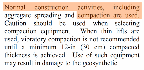

I am gonna be more precise.
This is an MSE wall about 8 m high composed of crushed tuffa excellent fill material , something you guys would classify as A-1-a. the contract specifies modified proctor references while i used to believe that a standard test would be enough especially since there will be no vehicles circulating above the wall when the project is delivered. Vibratory equipment is prohibited since the MSE function is to protect a small cliff harboring an archaeological site from falling .
I made the preliminary decision of accepting about 90% of the modified Proctor MDD.
Edit: iv'e checked out some pdf on the net and some of them recommand using 95% from the T-99 AASTHO for slopes and walls and 100% for walls supporting foundations

This has always been a controversial issue and varies on a regional level in the US. The fact that MSE is involved should not alter the density requirements as it tends to be a soil strength and consolidation issue related to the function(s) of the structure. What does the MSE structure support when done? Any displacement requirements? What is the maximum lift thickness going to be? and so on.
If there are minimal fines in the A-1-a backfill( <5% would be preferred if vibratory equip is not allowed), the differences will not be significant and just use 95% of whatever you want. I do not think anyone would endorse 90% if the fill is expected to behave. If there are fines then moisture and method will come into play. The ultimate method in my opinion is to run a standard and modified density series and compare densities and moisture contents. It is pretty easy to see how the material responds to extra effort and what the moisture content does.
