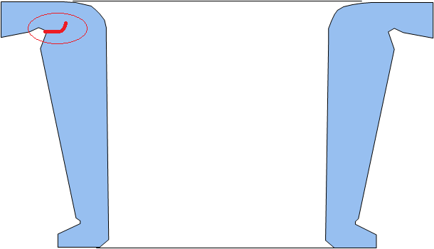

I am facing quench cracking during plug hardening of ring with oil quench (`40C).
Hardening temp at 830C. Ring is transfered to plugging press and quenched with oil.
Material is A485-1, ring dia is 250mm and thickness is 23mm.
Crack always in the same location of undercut. Any reasons / solution ?

Sounds like this ring is intended for a rolling element bearing race. A sketch of the ring cross section and undercut would be helpful. Also a sketch showing how the quench die interfaces with the ring, including any oil flow paths provided, would be good.
Is the quench die possibly restricting oil flow to the undercut surface?
RE: Crack in A485-1 ring during plug quenching
Hi tbuelna yes you are right.
Quench die is not restricting the oil flow to the undercut. Undercut is open to oil.
I have shown a small sketch for understanding. And crack always on the top undercut area.
Die is a taper die which sits on both top and bottom bore. Oil flow is from both top and bottom.

Of course the crack is always at the top undercut area. All things equal, failures always occur at the weakest point, which in this design would be at the top undercut. That does not necessarily mean it is a design issue though. Again, you need more than just the testing you did - you need actual failure analysis from someone experienced in the process.
Without a sketch of how the quench die(s) constrain the bearing race, how the oil flows over the race surfaces, it's hard to offer potential solutions to resolve your fracture problem.
In general quench cracks often occur where there is a significant local difference in heat transfer and cooling rate. The re-entrant profile of the grinding relief might be creating a separated recirculating local flow condition preventing the cool bulk oil flow from reaching the obscured undercut surfaces, thus inhibiting local heat transfer significantly. Also, the radial section is thick below the undercut, the flange above the undercut is even radially stiffer, and the narrow undercut groove between with its relatively small root radius provides a very effective local stress concentration.
Might be worth spending some time on modeling to optimize the cooling oil flows and heat transfer of your quench tooling.

Haran, based on what you have told us, it appears that the crack is forming at a stress concentration located in the undercut. You should make the radius in this location as large as the design will allow. The oil flow in this same area will very likely be reduced due to the formation of a vapor barrier that is trapped in the undercut because of the geometry and the manner in which you have chosen to orient this part during quenching. I would suggest that you flip it upside down from the orientation you have provided. When a vapor barrier forms during the initial stage of quenching it will not be locked into position in the undercut if you do this. Your oil flow rate around the part should also be carefully selected so that the entire cross section transforms to martensite, but the oil flow rate should not be so fast that cracking occurs. What is the oil flow rate that you are currently using? The pulsing capability on the quenching machine should be activated. Have you been using pulsing?

Hi Maui we have already tried by flipping the part upside down but no use and parts still cracked. Bottom oil flow is 300 LPM (this is to quench bore) and top flow 350 LPM (to quench OD) In our quench press we do not have pulsing facility.
Do you suggest to reduce the oil flow and what is your recommendation.
Several changes are required to reduce the severity of your problem, and one of those changes should be flipping the part as recommended. The second change is to increase the radius of curvature at the stress concentration where the crack is forming. The third change is to reduce your oil flow rate by 50%. If you had pulsing available I would also recommend that you activate it. Pulsing in these situations is often critical, and without it you may not be able to completely eliminate this problem, although implementing the other changes will help improve the situation.

Exit temp is 50 C.
Quench time is 160 Sec.
Ok let me try with reduced flow rate.
Hi Maui,
Reducing the oil flow did not help, upon further reduction we are getting NMTP.
Undercut design change not possible. Will update you all after further trials.

Haran, if you free quench these parts in an open oil tank and don't use your quenching machine, do they still crack?
Maui
No it does not crack.
In quench press with out die only with quenching also it cracks.
