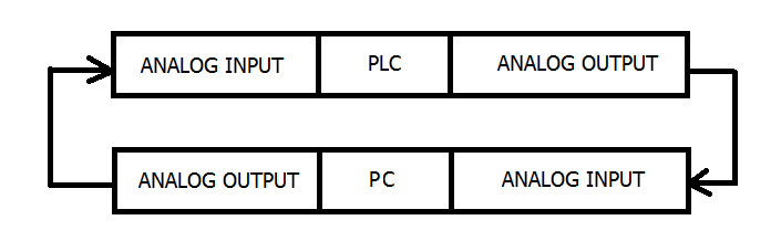

An analog output signal generated by SIEMENS DCS needs to transfer a package unit PLC (also by SIEMENS) through an analog input channel as depicted below. Question is, will work or an isolator will be need?

RE: AI to AO Direct Hardwire
This reminded me of such a system
It is used to debug the control algorithms on the PLC, PC plays the role of a plant.

IRstuff, among the beginning engineers there are a lot of terrible stories about how analog inputs die. Simply AzArsha is not sure.
You haven't supplied enough information. For example are the analog outputs isolated from one another (no common wire)? Also are the AI on the package system isolated? If the answer is no to both, then you will need isolators. In general you cannot connect two non isolated devices.
