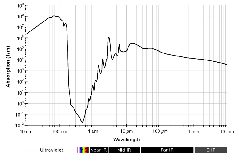

Actually, pure water isn't colorless, it's a bit on the blue-green side, as evidenced by is absorption spectrum. This is one reason that laser mine detection systems use blue-green lasers
