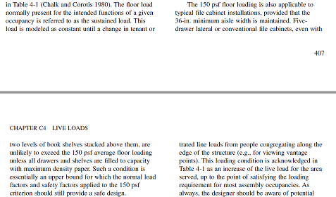

from 7-10 commentary:

The 150 psf if for filing cabinets that are 'fixed' complete with access rows. When it is possible to stack the filing cabinets in a dense pattern without space between, you have to design the area for the actual loading. Often cabinets are 6 drawers high, sometimes 4 and sometimes 10... The 150 psf may not accommodate the actual loading which should be designed for (This is likely code stipulated for storage areas).
The design loading assumptions should be clearly provided in the area by signage stipulating the max cabinet height and loading.

I'd also go with the ASCE value of 150 psf.
Trying to guess the exact weight of the file units, both now and whatever they decide to add in the future, seems like a mug's game. If you go that route, I'd add at least 25% to the calculated load (the same strategy I use for rooftop mechanical units, which seem to have the Heisenberg-like property of never being certain). 150 psf is the most defensible number since you can point directly to the code provision, and it's hard to see it having much of a cost impact unless you're talking about an entire floor of storage.
