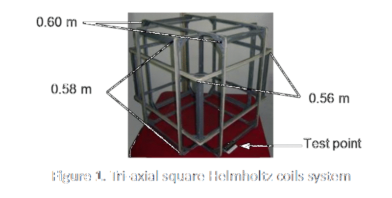

The typical fixture uses a Helmholtz coil, which provides the artificial magnetic environment, and can be used to perform all sorts of testing on magnetometers. I'm surprised you haven't scoured the websites of your competitors for such information.

Oh, OK, then most of what I listed are barely needed. Generally, then, a "tumble test," will get you pretty much everything you need. You could do that either with a Helmholtz (see below) coil setup or just reasonably far away from other things. A tumble test basically involves rotating the compass throughout 3 DOF in angle space; no translation is required, per se. The collected data can then be used to calibrate for both field strength and orthogonality. There's a Matlab file available for download that does calculations. You can use a 3-axis gyro to get the angle measurements.
This is similar to what we used for compass calibration, but the actual volume of controlled magnetic environment is pretty tiny.

Looks like there are some pre-packaged set ups out there: https://matesy.de/en/products/magnet-measurement-calibration/helmholtz-coil
Since the goal is to do this indoors, could I simply perform the tumble test using the Helmholtz coil with my current method of calibration, with respect to the Least squares method? Basically I'm wondering if I can perform the calibration using the Helmholtz coil without having to change my software. I'm guessing that I probably can't do that because the strong magnetic field will skew the current calibration curve.
