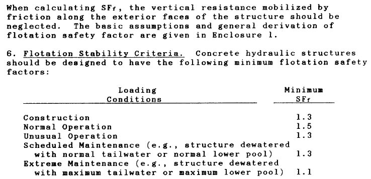

What design standards exist for the design of ballast against uplift forces, and what factor of safety against uplift do these design standards promulgate? I am familiar with a typical FS of roughly 1.5 against sliding forces due to active soil pressure for the design of many types of structures (including cantilevered retaining walls and gravity dams), but I am not aware of any such standard FS against uplift.
It is possible- perhaps likely- that the safety factor can vary depending on the nature of the loading. Specifically I have in mind uplift due to wind. But other forms of applied uplift may include: buoyant forces, dynamic/static pressure applied by some other fluid (e.g., water, etc.), and load transference forces (perhaps in a machine where ballast is used to counteract forces applied to some arm/member).

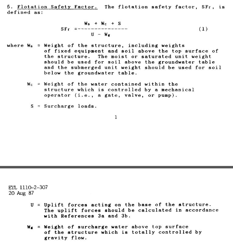

RE: Industry standard factor of safety for ballast design
USACE has criteria for a flotation stability safety factor. See ETL 1110-2-307 FLOTATION STABILITY CRITERIA FOR CONCRETE HYDRAULIC STRUCTURES. this is intended to apply primarily to dams, locks, pumping stations, conduits, canals, spillways etc.
Very helpful; 1.5 seems in line with the typical sliding safety factor as well. Purely subjectively, 1.5 also just feels about right. But I still wonder if 1.5 would be appropriate for the case of wind uplift.
