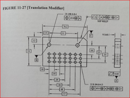

RE: datum translation questions
I am trying to answer a question related with the translation modifier and my intent is of using this picture, but I am not sure I understand it correctly: why position is used (instead of perpendicularity) for the datum feature B hole? (position at Ø (MMC) to A) for Ø8.0-8.4mm holes . The picture (as discussed previously) is from one of Jim Meadows books and I am not trying (in any shape or form) to disagree with such of GD&T authority.
Could one of you explain what I am missing from this picture/part design intent?
I guess 2X is applicable for size only because one of the holes is datum feature B and the other is datum feature C.
Is the intent to control the mutual relationship between the holes? Then why datum feature C is needed?
Thank you for your help in this matter
Some initial thoughts, greenimi... To me the translation modifier seems unnecessary here, because the MMB modifiers tell us that any gage pins going through there will already be accounting for the large holes' position tolerance.
IOW, if we make a fixture with two pins of Ø8.0 (virtual condition), any hole larger than that will be permitted to drift around while still keeping a stationary pin.
The reason position is used rather than perp is that it's relating the 2 holes to each other (notice the 2X). That said, he could have hung the datum feature symbol for B under that position tolerance, which would create a pattern datum and essentially mean the same thing.
Also, to be in line with the Y14.5 standard, he should have placed the note for SEP REQT under both FCFs that reference A, B, C.
Quote (Belanger)
It's needed here because the designer chose the option of labeling only one hole as datum feature B. The last degree of freedom (rotation) is why datum C was added. But as I mentioned, they could have been streamlined into a single datum B, which would have controlled all necessary degrees of freedom.
Quote (Belanger)
And since the datum feature B is only one hole then why not perpendicularity is used instead of position?
That has been my question from beginning.
To recap:
If datum feature B is defined by the two holes (pattern) I agree position should be used and then no datum feature C needed. If "C" still needed I am not understanding why ?
If datum feature B is only the left hole then why perpendicularity is not used (instead position) and then I agree datum feature C is needed to stop the rotation left.
Quote (Belanger)
That aside, what do you think about translation being used along with MMB?
That is exactly what I am trying to answer: Someone asked the very similar question on linkedin (if the translation modifier can be used with MMB modifier ?) and I know has been discussed here on eng-tips and I also knew that pmarc attached even a picture from Jim Meadows book. I found the "culprit" picture, but I got hung up on the position versus perpendicularity conundrum described above. (why position and not perpendicularity). Since I did not want to confuse the folks on linkedin (more they are already). I said that is better idea to ask here for my own edification first.
Anyway, going back to my original questions: I checked out fig 4-19 (ASME Y14.5-2009) and datum feature B is shown only with perpendicularity (relative to A primary) and then datum feature C is shown with position (relative with A primary and B secondary at RMB). Then the translation modifier is used on C also at RMB.
Jim Meadows case (from his book) shows B with position and C at MMB with translation modifier.
My follow up question is: should I understand that the pattern of those two holes is datum feature B (2x Ø8.0 -8.4)? So, those two holes together make THE datum feature B and then from this pattern is "extracted" one of the holes to be datum feature C modified at MMB and used with translation modifier? Otherwise how else I can understand Jim's picture ? Should I understand that the design intent on Mr. Meadows book was to call out both holes as a datum feature?
Or should I understand that if the datum features B and C are RMB then we have to use perpendicularity for B and position for C (such as Fig 4-19) and if datum features B and C are MMB then we have to use position (to tight the hole together) and "extract" C from the pattern to be able to use modified at MMB with translation modifier?
greenimi:
Let me add my two cents.
Quote (greenimi)
I wrestled with this "conundrum" too. Bu then I realize perpendicularity control can only be applied to a single feature. When it is desired to control the position relationship between features in a pattern of features (holes in this case), position becomes the primary control due to the BSC dimension between features (holes). Perpendicularly (in this case) is implied due to the undimensioned and assumed 90-degres BSC relationship with the primary datum.
If you wanted to refine the perpendicularity requirement, you might consider composite position control with the position tolerance greater than orientation requirement. Additionally, in fig 11-27 I guess you could apply a perpendicularity to datum A FCF below the position FCF and put 2X INDIVIDUALLY next to it. Case studies are great. But in he end design requirements drive all of this.
I have the Jim Meadows book and I thought his explanation of fig 11-27 on the opposing page was pretty clear, though the text implied confusion as to interpretation.
greenimi:
My interpretation of the fig 11-27 drawing: because the datum feature symbol is directed to one of the two holes and is NOT attached to the position FCF, only that hole and not the entire pattern is the datum. See 14.5-2009 para 3.4.6. So datum C is appropriate.
As I said thought Meadows' explanation of fig 11-27 on the opposing page was pretty clear. It discusses the different datum sequences and how they are the same or different. Do you have the Meadows book? Let me know and if not I will copy and attach the page to a post.
Greenimi -- I agree with mkscski. There is nothing on that print to indicate that the datum feature symbol for B is meant to apply to both holes. For that to happen, they would have to do one of two things:
Put 2X before the existing datum feature symbol, or
Associate the datum feature symbol with the position tolerance which is already tagged to the 2 holes
I hope I didn't confuse you; my own comment was that it would have been more straightforward to do that. Thus, datum C wouldn't be needed. But it this case datum C is needed to complete the "degrees of freedom."
But back to the translation modifier...was there a consensus on the LinkedIn discussion about this? I don't see why translation would be needed when the MMB modifier already accounts for the position movement of datum feature C. Maybe their thinking is the rule about the "exact same datum references in the exact order" etc. But the relationship between B and C here is already implied.
Quote (mkcski)
Okay. So, if one the left hole is the datum, then its relationship with the primary is......position or perpendicularity?
You have datum feature A primary, first thing in the universe (part's universe) and then you have the left hole, second thing in the part's universe oriented to the first/ primary datum feature. Why position is shown beats me (as we decided that only the left hole is the datum feature and not the entire patten of theose two holes). In this case (case of only left hole and not the entire pattern) the relationship between primary and secondary is orientation. Secondary is only oriented to primary as nothing else exist yet. Tertiary datum feature C will come latter.
No, I do not have the entire book, I have only what pmarc posted on the previous thread. If you have and you are willing to copy and post anything else which is relevant and you think will help me (and probably others) understanding the problem/ issue I will appreciate that. Again, anything relevant to this discussion is helpful.
greenimi:
See the attached
I think you are "connecting" to many datum "things" that are not connected. Might I suggest you create what I call "cartoon" gauges to inspect each of the FCF's. You will get into related and unrelated mating envelopes. I think this will clarify most if not all of your questions.
Quote (Belanger)
Okay. So, we agree that datum feature B is only the left hole and datum feature C is needed (and should be positioned to A primary and B secondary)
Quote (mkcski)
Thank you for posting Mr Meadows clear explanation. I guess it is the same as the one posted my pmarc in his first post.(but a little better quality).
Now, about the "connecting" things , I am really not sure what would you mean? My assumption is that everything is connected as it is a common language GD&T.
Still not sure why perpendicularity was not used instead of position for datum feature B. Hard to belive it is an overlook/mistake.
I think I've found the root of the problem: As pmarc stated, the apparent reason for the translation modifier was to change "the default requirement for relationship between tertiary and secondary datum feature of size simulators..."
Yet in the picture you gave, greenimi, the relationship between the secondary and tertiary datum features is not expressly given! Rather, the relationship is intertwined in a common position tolerance of the two holes. I guess this is the reason for my beef about the drawing.
greenimi,
The scheme shown in FIGURE 11-27 is as follows:
    both holes:
        diameter 8.0 - 8.4
        positiondiameter 0 (M)A
    left hole:
        datum feature B
    right hole:
        datum feature C

    left hole:
        diameter 8.0 - 8.4
        perpendicularitydiameter 0 (M)A
        datum feature B
    right hole:
        diameter 8.0 - 8.4
        positiondiameter 0 (M)AB (M)
        datum feature C
Does this alternate scheme seem better to you? It is exactly equivalent to the original.
EDIT: B (M) was B. (Thanks to Belanger for catching that)

Quote (pylfrm)
Yes it does. for a couple of reasons:
- align with shown examples in the standard where perpendicularity is used instead of position.
- I also remember J-P Belanger had a thread (long time ago, few years ago) where he express the concern of using position when perpendicularity was the only thing controlled and has been concluded that perpendicularity is a better callout.
I did not say position is an illegal callout for this case, but orientation is all what is needed in this case.(better grammar)
Since B (only left hole) does not have a locational relationship to A then perpendicularity is a better callout. If you (actually Mr Meadows) chose to use a position for B relative to A my question would be "what is the nominal (basic) distance of B relative to A"? If you can't tell me how far B is supposed to be from A, then position would not be the correct callout. If one were to use position in this context anyway, its only effect would be to orient the feature's axis relative to A anyway. So at best it would be accomplishing the perpendicularity requirement, but with "poor GD&T grammar".

Quote (greenimi)
The position tolerance is not being applied to datum feature B alone. It is being applied to the pattern of two holes, and it controls the locational relationship between them. If it were replaced with perpendicularity, the distance between the two holes would no longer be controlled.
Take a look at ASME Y14.5-2009 Fig. 7-37. It shows the practice that you are objecting to.
EDIT: 2009 was 209.
Quote (pylfrm)
Not sure I got your reference to the multiple patterns of feature fig. 7-37.
What do you mean? What practice is shown?
In this picture, there is a location relationship between the small holes (controlled holes) and datum feature D (big hole)---basic dimensions should be shown somewhere on the drawing.
In Meadows case the only relationship between B and A is orientation and no basic dimension / location relationship is shown between B and A.
There is a location relationship between C and B and for that I agree a position should be shown (but I did not object to that and that is entire different animal)
Could you, please explain it with more details? You are one of the authorties here on this form and I would like to learn if I am missing something.

greenimi,
I am referring to the diameter 0.4 position tolerance in Fig. 7-37. The primary datum feature (A) is a single planar surface. The secondary datum feature (D) is a single cylindrical surface with its axis perpendicular to A, and is part of a pattern of six features controlled by a position tolerance having A as the primary datum feature.
It seems to me that the aspects of FIGURE 11-27 from the Meadows book that you object to are also present in ASME Y14.5-2009 Fig. 7-37. Do you agree? If not, can you explain what you see as the essential difference?
pylfrm
pylfrm,
In Fig. 7-37 the position you are talking about is for the four holes (Ø 3.6±0.1) and establish the relationship between themselves/ mutual relationship between the pattern of holes and I agree to use position/recomanded callout
In Mr. Meadows picture/case, since only left hole is datum feature B and the right hole is datum feature C
Quote (pylfrm)
left hole:
datum feature B
right hole:
datum feature C
is no pattern made/constructed and consequently it is not the same scenarios as shown in Fig. 7-37 in the standard.
if your argument is, lets make a pattern with/between those two holes (call it pattern datum feature B) then my follow up question would be : why you need C for?
I am all for learning, but I guess I kind of got stuck and I need your or anyone else help in this case. Thank you

Pylfrm...I haven't followed the latest aspect of this thread in great detail, but I also don't see how Fig. 7-37 applies. The question is not about things being positioned back to the secondary datum, but rather that secondary datum's initial relationship to the primary datum. But I think you nailed it with your FCF comparisons in the post from January 30.
Greenimi...It's true that the position tolerance of datum feature B only references datum A, thus implying perpendicularity. But I keep pointing back to the "2X" indicator, which adds another aspect to the geometric tolerance. Since two holes are being tagged with that position callout which references A, then they are automatically located from each other. This has nothing to do with the datum letters in the position tolerance; it's all about the 2X.
John-Paul Belanger
Geometric Learning Systems
I would say/argue that 2X is applicable for size only in this case.
If 2x is applicable for position too (to establish the pattern relationship and move away from individual relationship) then why C is needed?
The 2X indeed applies to the geometric tolerance, not just size. Think about an example such as Fig. 4-18 in the standard -- surely you agree that the "4X" makes that position tolerance apply to each of those four holes. This has nothing to do with datums; it's just the idea of using the "X" indicator to impose any GD&T upon multiple features.
So moving on to the datums... The "2X" applies to the position tolerance, relating them to each other, as well as A. But Meadows' figure does not use "2X" to label datum B. How can we tell? Because the datum feature symbol for B is using a separate leader line. It is not given the "2X" notation. Therefore we must interpret datum feature B as only the left hole.
So we have a somewhat strange situation where the two holes are grouped together for a position callout -- implying they have equal importance -- yet they are split apart for the purpose of creating datums B and C.

I agree with Belanger. That is how I always interpreted that meadows figure.
I am aware that if you have A-B multiple datum feature primary (two coaxial features for example, or maybe even two features dimensioned with basic dimensions apart) you can use position or runout in a such of way that: first feature is position or runout to A-B and this is called datum feature A
Second feature is position or runout to A-B and this is called datum feature B
and my case described above IS NOT self-referencing.
But, now in Mr. Meadows case...call it strange situation (but I am really not sure why needs to be) ..... holes are grouped together for position callout, but they are split apart when the datum deference frame is created.....well that is beyond me.
That's why I am asking.
Not sure I understand Mr. Meadows concept.
Not sure I have seen it discussed here on the forum before and
also not sure it is supported by the standard.

Like AndrewTT, I agree with J-P. So after reading the last few posts, I refer you back to my attachment on 29 Jan 13:39 from J Meadows that explains several scenarios for the two holes and how they can be used as datums.
Quote (Belanger)
Here I do need more details how to be done and I am questioning its legality. For me looks like...... how can I say it……not so kosher.
Quote (mkcski)
What Mr. Meadows is talking about in your posted text it's less relevant, in my opinion, with what I am questioning .........
I would say it's legal to split up B and C. But I don't like it much :)
That's why I earlier referred to the standard's method of grouping them together as a single datum (Figs. 4-26 and 4-39).
I can live with that, but I am still noodling why the translation modifier would be used when there's already an MMB modifier.

J-P:
J Meadows is on the Y14.5 Committee. He explains the reason why the modifier is "confusing" in the 29 Jan 13:39 from attachment. You might want to give it a read.
Quote (Belanger)
Well,..... you don't like it ....which is a step above ......as I do not understand it.
Quote (mkcski)
Probably, Mr Meadows wanted to create even more confusion by posting, in his book, the picture above -- to demonstrate that the translation modifier is "useless"--
Translation modifier usefulness has nothing to do with B and C datum structure (especially position callout) where we “kind of agree” is not like-able and the disappointing thing is coming from a known authority.
Thanks mkcski... That helps me see the perspective. Even with the MMB modifiers, the translation modifier has some value, I suppose, but still pretty confusing. The example in the standard works for me (but it was RMB).

Quote (Belanger)
I know:
Quote (pylfrm)
The above description applies equally well to the Meadows example if you replace "D" with "B", and "six" with "two".
Quote (greenimi)
That is not my argument. The purpose of the figure is to demonstrate usage of the translation modifier on a tertiary datum feature reference, and to provide a reference for the discussion on the previous page. It would make no sense to remove C in that context.
pylfrm
Quote (pylfrm)
Okay.
So, why the same concept used by the standard in Fig. 4-19 could not be used here too? In other words, “B” secondary with perpendicularity to “A”, then “C” tertiary with position to “A” and “B” (all three datum features RMB)
Only because “B” and “C” are now at MMB (not RMB) is an enough good reason to use this (in my opinion) “shady datum scheme”?
Isn’t it more clear/ robust and even supported by the standard the same datum scheme as shown in Fig 4.19?
I am struggling understanding Mr. Meadows concept: “where the two holes are grouped together for a position callout -- implying they have equal importance -- yet they are split apart for the purpose of creating datums B and C.”

greenimi:
Quote (greenimi)
I always try to envision and sketch if necessary "cartoon" gauges that would inspected the GDT requirement to get a clear picture of what is being controlled. I use this a lot when I teach and it really helps students "see" what is going on. In this case there are two gauges. One gauge would check the positon of the two holes - nothing else. It would have a flat plate to simulate datum plane A, and two pins at the virtual condition (8.0 dia). The other gauge is the one in figure 11-27, which uses the two holes as datums B and C to check the GDT requirements other features. The part must pass both gauges.
Quote (mkcski)
Well, I am not asking about how to check the holes with the gages. In both cases (with the perpendicularity and with the position) inspection method with hard gages will look the same. The gages look the same, same size gages, same basic distance apart. Again, only the gages to check "B" and "C". Would you agree?
I am asking about how the plate has been defined and how should I read the product definition of the plate. Either the holes are together (making a pattern) OR either the holes are separately.(one ”B” and the other “C”). Looks like in Mr. Meadows book case the holes are both. Should I understand that this case is for academic purpose only?
“You can't have your cake and eat it too”
Do you see this practice legalized somewhere in the standard? If yes, I am all for learning.
