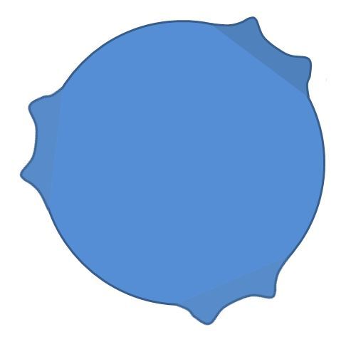

Now, there is the cylinder with 3 interruptions, as shown in OP. According to Y14.5, what checks need to/can be performed in this case?
And finally, what requirement(s) on the OP drawing (regardless if 3X prefix is used or not) prevents the actual features in question from looking for example like this?

Thank you for the aswer. I agree with you that Rule #1 could be confirmed, but would that be according to the letter of the current standard? Verification of Rule #1 is a must in case of regular features of sizes, but is the feature in question a regular feature of size?
Regarding the size verification (or actually the LMC size of the feature), per my knowledge Y14.5-2009 gives no information about how that kind of callout applied to that kind of a feature should be interpreted. In other words, the callout is subject to multiple interpretations.
In the draft of new standard the committee (finally) defined a method of interpreting size callout applied to regular feature of size with localized areas that do not contain opposed points (para. 5.7.1 and fig. 5-9), but this is good for a future, not for today.

Regarding Rule 1 and the cylinder with 3 interruptions: I agree that questioning if we "must" test for conformance is equally important to questioning if we "can" test for conformance. Even though I answered that, yes, I think we "can" test for conformance to Rule 1 in this case, I do not think the results are equivalent to a whole cylinder passing the same test. The interrupted shape can have poorer form while still fitting in a given envelope. So, what does passing the "test" actually mean? It would guarantee assemblability in "pin in a hole" situations, but is that all we rely on Rule 1 for?
