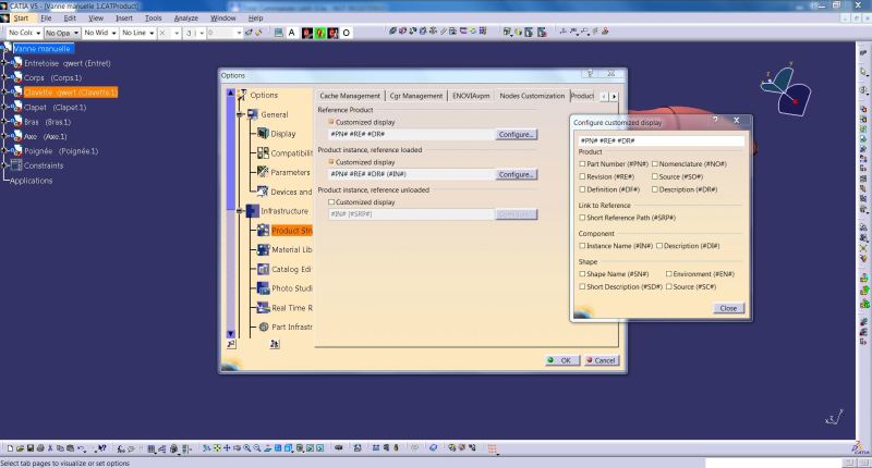

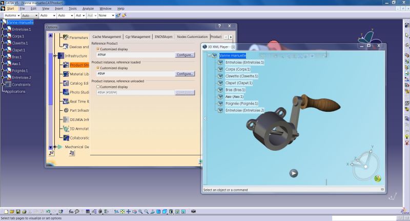

hi all,
i would like to create a macro that will change part number and will be the same as instance name.
because when i'm exporting catia product to 3dxml file it copies both partnumber and instance name in the specification tree, I only need to show instance name.
thank you and regards,

hi thanks for the replies. but can i also just delete the instance name and how?
RE: MACRO PART NUMBER WILL BE THE SAME AS INSTANCE NAME, HELP
or i have an idea just delete the part name and leave the instance name
