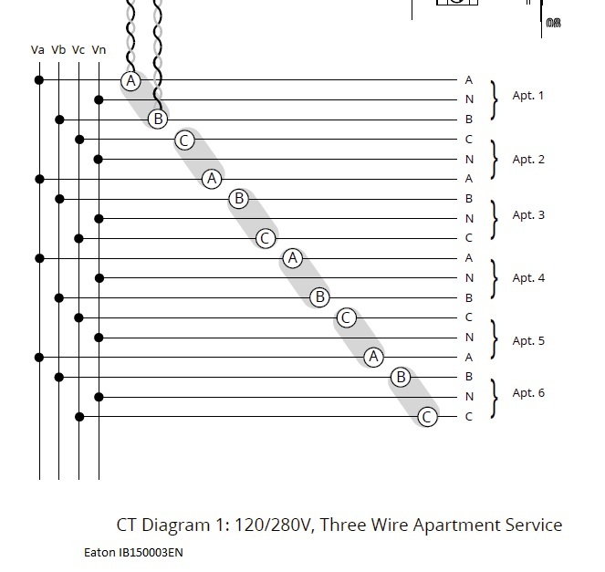

good day, I'm needing to design a three phase transformer but I'm not sure I've been given the correct direction on how to go about it. the direction I was given is to assume it was all three phase, but this can't be right.
I'm designing for apartments, which is all 1ph load.
we will be utilizing three phase pad mounted transformers are 208Y/120V (for these services).
let's assume the following: 30 units, 2kva each.
my co-workers tells me the 3ph transformer (if they made this size) should be 60kva. this is where I disagree. I do not have an engineering degree but I've designed tons of three phase commercial projects, and tons of single phase projects (using single phase transformers). this is the 1st I've done an apartment complex.
my question is, if I have 30 units, each using 2kva of single phase load. wouldn't my main, 3 phase panel have 10 feeders on AB, 10 on BC, and 10 CA? where each feeder having a load of 20kva. with this, you would think each leg would only see 40kva? (or maybe it works out to be 60kva div square root of 3) which is 34kva +/-.

Your co-worker is correct, assuming that the 2 kva per apartment is after all the applicable demand factors.
Apartment buildings usually have two hot legs to each apartment. Normal 120V outlets are connected between neutral and either one of the hot legs. Stoves, water heaters and dryers are connected using both hot legs at 208V.

Your revenue meter sockets must be suitable for five jaw meters.
In regards to your theory that each feeder sees 40 KVA;
resolve the KVA into amps per phase, consider the phase angles and add the directed vector sums. The answer will be a current that reflects a 60 KVA load. (Thanks David)

not all your loads are AB, BC, AC, usually only (as Bacon4life said) "Stoves, water heaters and dryers are connected using both hot legs at" 240V. The rest are going to be 1 phase and a neutral. sizing each leg only helps you with balancing your panel. The overall TX is the one that sees 60kVA.
I think you are getting confused between 3-ph and 1-ph loads & tx. do what waross said
"resolve the KVA into amps per phase, consider the phase angles and add the directed vector sums. The answer will be a current that reflects a 60 KVA load. (Thanks David)"

The simple rule is Power in = Power out. So, if the power output is expected to be 60kVA then the power input is 60kVA. The only way to get 60kVA of power input is using a 60kVA transformer.
Now, there is a caveat for 3-phase. The power has to be balanced between the phases. Fortunately, you are balancing the loads between the 3-phases so it should be fine.
You're getting confused because the TX is Y connected. You're adding the power directly instead of using the correct vector sums.
The easiest way is to think of it as L-N loads only. 20kVA on A-N would put 20kVA on 1-coil of the TX. Since the TX is 3-phase there are 3 coils so multiply by 3 and get 60kVA.
