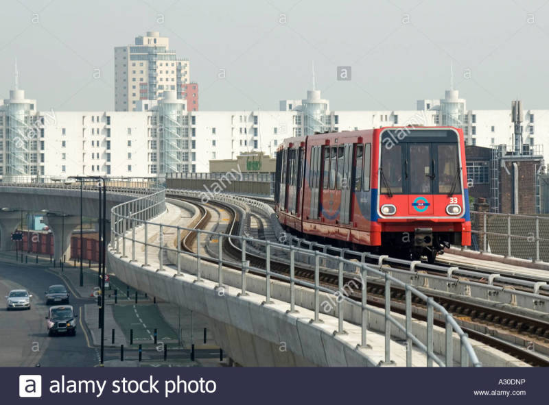

Not really on topic here, but I can't see anywhere else where there are barriers stopping the train, which is after all on fixed rails, from impacting with vehicles / people by means of barriers. The only ones I've seen are on elevated curves on the Docklands light railway and then it's personnel barriers.
Normally this is the other way around, i.e. stopping vehicles which are not running of fixed rails, from crashing into, swerving, stopping etc in the way of the train causing it to stop / crash/ de-rail.
This seems to be a large expense for very little reduction in risk and a very low probability.
How many trains do you think are going to jump the tracks and fall over?
Modern light rail systems incorporate safety systems to stop or slow down trains before they do anything fast enough.
This seems to be a very poorly thought out exercise, but maybe there is more to it?
