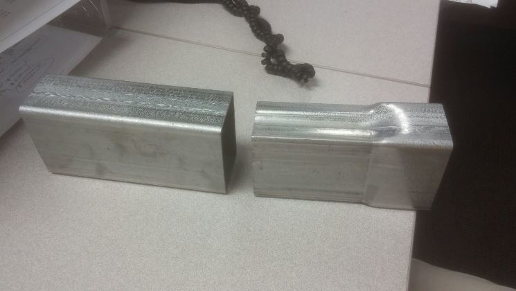

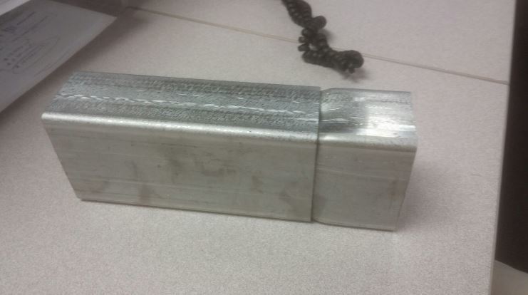

I've got a project where they're wanting to used a bunch of these swaged connections. Pretty simple: squish one tube a bit and shove it in the other. What's not so simple is evaluating the capacity of said connections. In particular:
1) How can one assess shear capacity?
2) How can one assess compression capacity?
3) Can compression capacity rely on the geometric interlock or should screws be installed to get the job done instead? I would need a lot of screws for my application. And some related industry offerings lead me to believe that compression capacity can be had without the screws: Link
I have contacted some tube manufacturers as well as the tube steel institute. Thus far, no fruit has ripened however. We've discussed tube in tube moment connections here in the past but that would seem to be a different animal.
What say you?

None of the above. You definitely get some screws in through the side walls for tension applications.
I`m not terribly concerned about shear at the load levels being considered but, still, I`d like to be able to put a number on it. It`s compression that is my main concern. I get the sense that compression may be transferred via the outer tube bearing on the "shoulder" of the inner tube. But, then, that's the crux of my question really. Shoulder, screws, or both? Or would relying on the shoulder result in the screws getting sheared off?

I don't see an issue with shear, but compression would rely on how well formed the shoulder is.
If there is little to no shoulder then it is just a wedge trying to spread the end of the other tube open.
It would take some testing to validate those numbers.
Personally I would like to see screws through the sides of these.

for compression, not aware of any method to analyze it except for testing....it would be a very easy test to set up, by yourself, to get an ultimate compression value.....

I feel like if you had to throw a number at it... Maybe...
I feel like the load would concentrate at the corners. So you could check the surface area of just the arc lengths against allowable bearing. Then if we can figure out how to turn the axial force into a lateral force, we could check the buckling/yielding strength of the webs.
Ultimately though I think it has to be testing.

Pure shear - force at right angles to long (or short) height of the two tubes - or straight "down" into the tabletop in the photo's should be additive. Add all the different steel tubes wall areas together. Alt: If a deformed (squished) tube is a failure in shear - as compared to a complete scissors-like cut, then you'll have to experiment.
Compression forces (if no screwed member!) will crush the two together endwise, but you've already squished (deformed irregularly) the inner tube and forced it into the outer tube just to make the joint. Unfortunately, the point of contact is a nice "wedge" shape as pointed out above, and so you need to test the two several ties to get an average wedging force and deforming force. But really, once deformed, there's nothing to stop the outer from continuing to deform around the inner and slide together. Total deformation will be 1/8's or 1/4's of an inch, not 4's of 1/1000 of an inch.

I guess the key thing is how much load required to assemble the two pieces ?
Personally, I wouldn't trust this connection without testing some; or without adding "chicken" screws or blind ("pop") rivets.
