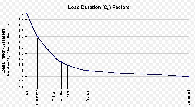

Not interested in live load reduction as the tributary area for a single deck joist is small so LL reduction just isn't applicable here. (we're talking 2x10's @ some spacing)
Specifically the duration of load for wood for live load per the NDS.
They specifically show:
combinations with Dead only - Cd = 0.9
Combinations with Live load - Cd = 1.0
Combinations with Snow - Cd = 1.15
Combinations with wind/seismic - Cd = 1.6
Corresponding to this curve:
For an exterior deck of about 12 ft. x 20 ft. - it must be designed for LL = 100 psf.
I get that - no problem.
But for the actual wood joist design we just don't see how a Cd = 1.0 (for live load per the commentary in NDS) applies.
Just seems like Cd = 1.15 would be more in line with the "large party of people" duration.

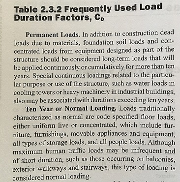

While I agree with the logic I think the intent for the code is to use a CD = 1.0. My understanding is that the live load for pretty much all uses is a worst case loading that the structure may only see once or twice in it's lifetime. Therefore, logically you should be able to use a CD greater than 1 for pretty much all live loading which is not how the code define the CD factor.
RE: Duration of Load Factor for Live Load
although there may be some logic, it seems the concept is ruled out by NDS
TBL 2.3.2 references occupancy live load for CD=1.0
Commentary expressly addresses understanding that maximum human traffic loads "may be infrequent and of short duration"
