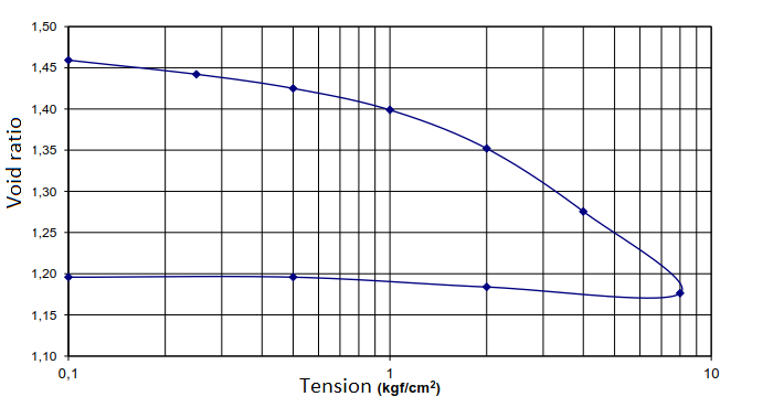

Consolidation test (see attached image)
Tension (kgf/cm2) Void ratio
0 1,472
0 1,478
0,1 1,459
0,25 1,442
0,5 1,425
1 1,399
2 1,352
4 1,276
8 1,176
2 1,184
0,5 1,196
0,1 1,196
0 1,203
2 1,184
0,5 1,196
0,1 1,196
0 1,203

Your consolidation test gave the Pc value is about 1.2kgf/cm2. I guess the Po+dp value will be in the elastic condition. So the Cr value will determine your settlement.

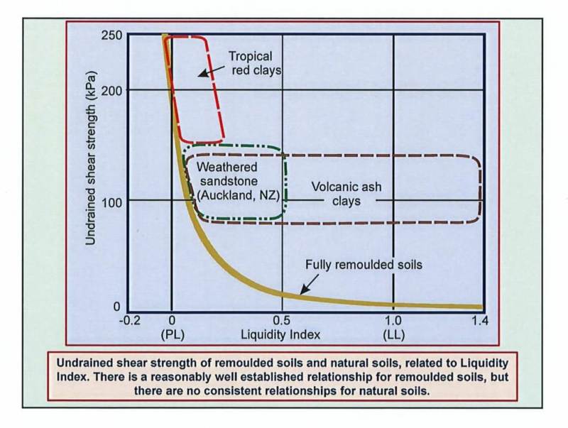

The residual clayey soils in my area also show higher remolded unconfined compressive strengths than the undisturbed samples strengths. My soils are unsaturated overconsolidated clays. This is interesting. I am not really sure about why this is happening and am still researching on this.
Anyways,for your footings which are 1x1 m and assuming that the Df is about 1m, your footings may not be greatly impacting the saturated silts that are at 4 meters below grade (depth of stresses influence for square footings for 10% of stresses at approximately 2B: 2m in your case). So I would use the elastic modulus from your unconfined compressive test and calculate elastic settlements of the silt layer. Again, consolidation settlements may be very small since the stresses for the saturated layer are low.

I've only ever encountered soil sensitivity (su,undisturbed/su,remoulded) less than unity when the soil had notable structure. The fabric/structure of the intact soil can result in weaknesses to loading in certain directions (and also extra strength when loading in some other directions). In such cases the process of remoulding can remove these weaknesses associated with the soil fabric/structure.
If there is no notable structure or fabric to the intact soil, then it may be the case that the testing had some issues. Was the remoulded test performed on the same sample with the same density and water content?

Thanks for your answer. I think the material is from volcanic ash (alofanic) and thats why the remould resistance is bigger than the indisturbed.
