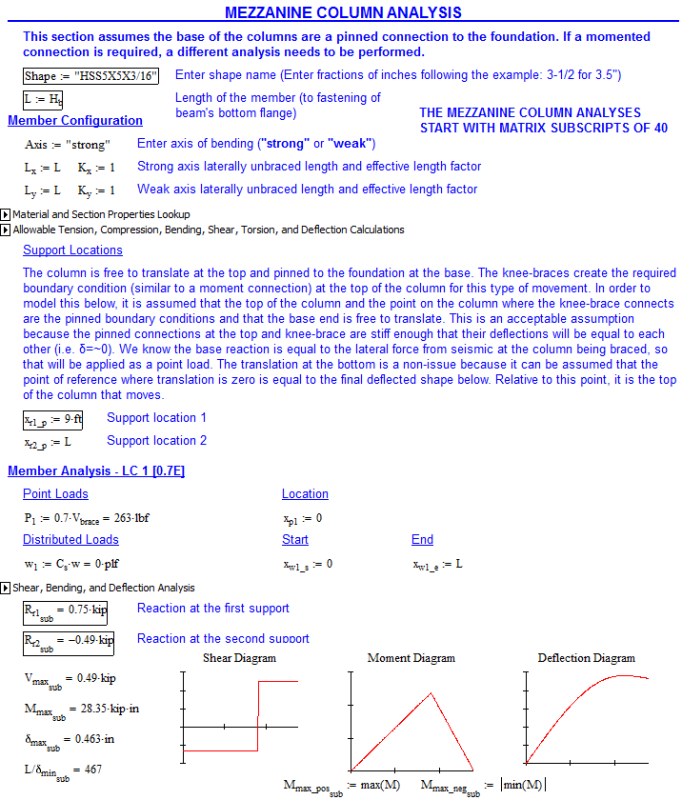

I am trying to calculate the brace force of the attached frame. I can do it easily in RISA, but I want to incorporate it into a MathCAD calculation because it will be easier and faster to produce a calculation set for future projects. I've been racking my brain to figure it out because I know the stiffness of each element affects the load that the brace sees. So, I tried to simplify the properties of the members in the attached. The brace has the weakest moment of inertia and and cross-sectional area, I and A respectively. I then made the other members have arbitrary factors of I and A. The column is fixed to the foundation. The beam and braces have pinned ends. I showed the force outside the one column, but it is actually at the center of the beam (diaphragm load) so it loads each brace equally.
So am I stuck using RISA for each frame that comes up or can someone provide a (maybe not simple, but shortish) method of calculating by hand?
On a related note, if the base of the column is pinned, I did an "equivalent" analysis of the column as a beam with pinned supports at the beam and brace and a point load (equal to 1/2 the force) at the foundation which is assumed the free end. This works with the assumption that the translation at the brace and beam are equal. This is not exactly true, but because of the stiffness of the members and close proximity of the two points, ends up pretty close. The pinned base requires a stiffer column to keep the drift down, hence my attempt at the above.

The base on some of these columns are not a (4) bolt pattern because of their placement against walls. They are plates extended to one side of the tube column with (2) bolts. I don't know if there is a typical name for such a base plate type, but I know it is common. That is why I was assuming pinned connections because that type of base is only good for a moment in one direction unless I super beef the plate to take the bending and eliminate (or calculate) the prying action. Which is very doable I suppose.
^ My thought process was progressing as I was typing and I walked my self through to that conclusion. I never learned the unit force method. By education, I am an ME and we only used Singularity Functions which I attempted to incorporate into this problem. I also tried reducing the beam, brace, and column into spring constants but that was getting me deep into math I couldn't handle last night.

rb1957: Prying is for a momented reaction. I was talking myself into your suggestion. If I want to consider the (2) bolt base plate as a moment connection, I need to look at the prying action of the plate. Before that statement, I thought the plate would just bend/deflect, not putting any tension into the bolts thereby making it a pinned connection. I think I like the fixed end condition regardless of anchoring pattern, so I will provide both options in my analysis.
My approach will be to model the frame for a 1 kip lateral load and get the values from the RISA model and enter them into my calculation as a snapshot. I will make the beam extension as short as possible beyond the brace for the worst-case condition. Then I will just factor my model results by my actual lateral force divided by the 1 kip model value to get the values I need. I think this is easier than providing the RISA report at the end of my calculations. Example below which is my work in progress and I need to add snapshots for column shear, moment, and deflection diagram:
I have no question on the pinned base condition:

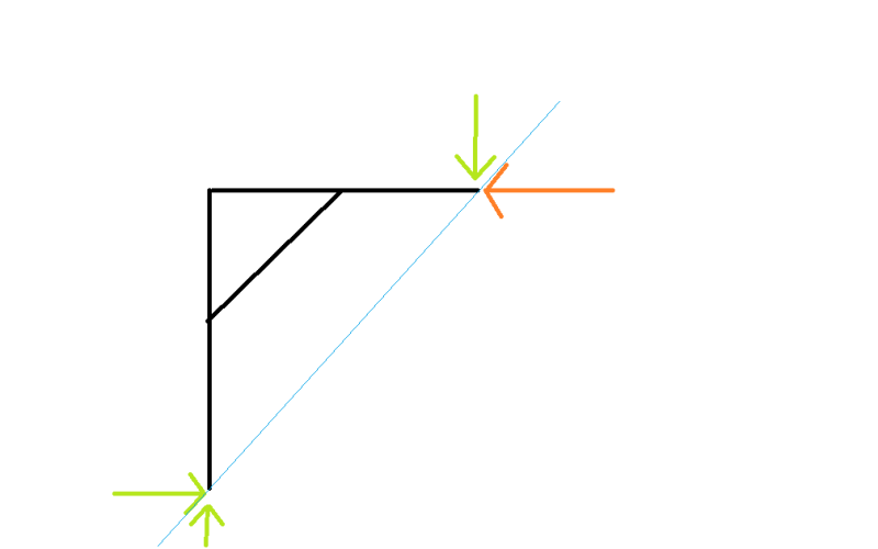

not sure I get your reactions.
the FBD for the 1/2 frame is incomplete, as there is a moment in the horizontal on the CL.
The horizontal reaction is 1000 lbs; the vertical depends on the width (or 1/2 width of the frame).
I take it the knee brace reacts only axial load. The vertical component of the knee brace works with the load in the vertical (at the top) to create a couple reacting the mid-span moment, yes? So this component will be larger than the applied load, so the reactions at the LH end of the horizontal beam are both vertical and horizontal.
If you're trying for a general solution (in your Mathcad), avoid using fixed dimensions from the problem ... input all dimensions.

"I don't need to put a moment boundary condition there" ... you're right ... the 1/2 frame is a two force problem, which shows there's shear in the horizontal (and this is how the couple to react the offset moment is developed between the two ground reactions).
the knee brace load carries the equivalent moment (ie if you had a fixed connection between vertical and horizontal you wouldn't need a knee brace, in the absence of a fixed connection the moment is reacted as knee_brace_load * distance_to_frame_corner).
I think this is what your FBD should look like ...
