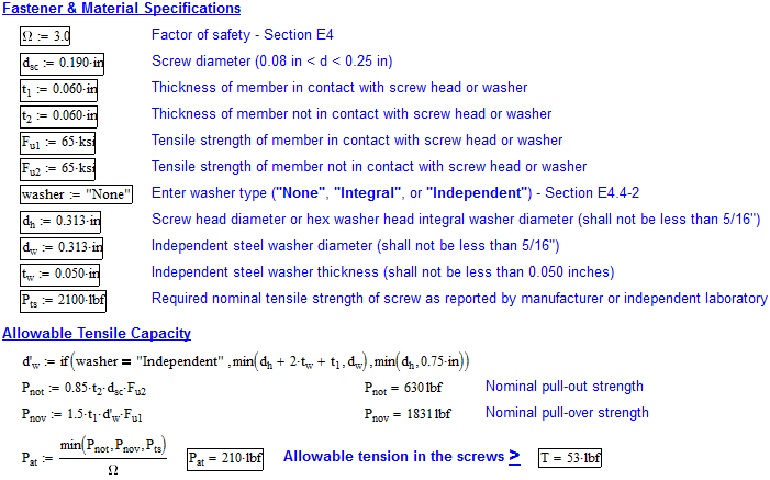

I'm also looking to find the formula for the uplift capacity of #12-14x1" self driller for the roof to purlin fastener.
I would think this is dependent on the roof gauge and purlin thickness, but can't find the formula to get for uplift capacity.

Agree with Triangled. Normally these tables have footnotes that same something to the affect that allowable loads were determined in accordance with AISI S100-Version. These value are for corrugated decks or standing seam roofs and from the values, looks like untopped (no insulation, concrete, etc.). The deflection loads are limited to L/180 and can be proportioned appropriately for L/240 or L/360. You have the section properties of the deck and the yield strength, so you could attempt verify the values.
You can use published screw strengths from the screw manufacturer if you can find values for matching conditions (base thickness/strength, attached thickness/strength) or you can use AISI (if located in the North America). An ASD example is below:

P1eng - is that spreadsheet in aisi website? I'm located in the US
RE: Roof R panel and fastener question
delagina,
No, that snapshot is from my MathCAD library. Nothing is hidden, so you could easily reproduce it in Excel if you like. If you want generic, then that calculation is for you. As far as generic span table, it will greatly depend on the profile of the deck and AISI checks are not something "generic". Hand calculations will require an iterative design process. I use a program called CFS to check formed sections, but it is not free. If it is the metal builders livelihood to bend decks, then they should be able to provide you with span capacities. If they just happen to be some outfit that has a roll former, then you need to make sure you specify minimum thickness and yield/ultimate strengths of coils.

The uplift capacity on the fastener is generally going to be one of two things:
1) fastener pull-out driven by screw diameter and thickness of supporting steel
2) fastener pull-over driven by screw head or washer diameter and the thickness of the roof panel.
