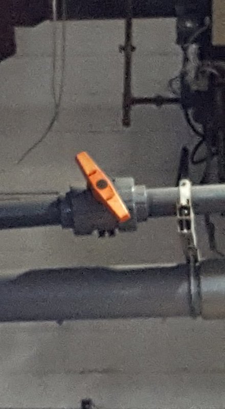

A 60% open valve is essentially open if it is an isolation valve.

The manual valve on the recirculation line is a 2'' ball valve. The 4'' discharge lines both have variable flow resistance, because the discharge locations don't need water all the time, so the flowrate is not consistent. On occasions, both 4'' discharge lines would have no flow in them at all. However, the discharge pressure gauge always reads ~80 psi.

Correction about the manual valve, it is currently positioned like this
And the two inch line is pretty long, it is a safety shower loop, and it recirculates around the whole plant, so probably around 4-500 ft minimum
