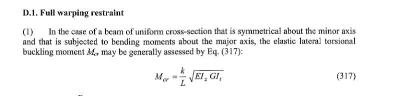

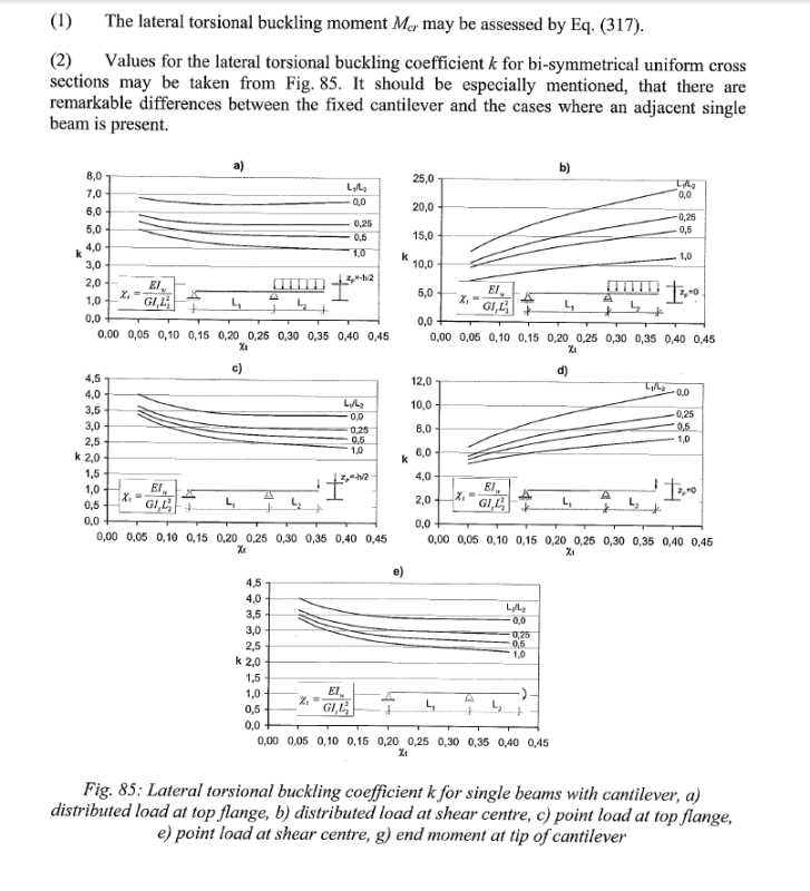

The Eurocode is notoriously bad in prescribing anything that has to do with LTB. I would suggest you have a look at 'Rules for member stability in EN1993-1-1' which is ECCS publication No. 119. As I remember, they have towards the end of the book a section which touches upon beams with overhangs, as yours.
That being said, with LTB it is becomes very difficult very fast as you move away from the standard simply supported beam case. You have a varying section, beam with overhang, loads acting both in the strong and weak plane of the c.s, filled RHS...you are as far as it gets from the standard case. The only thing that would have missed was to have the beam made out of some exotic material.
