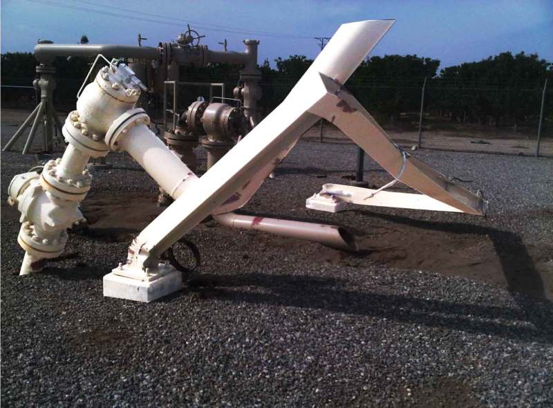

RE: PRD Reaction Forces
There is a force on the valves due to the high velocity flow, but in your case it is matched by the near identical force on the attached elbow pointing down. So long as the flange & pipe between the valve and the elbow is strong enough then these forces cancel out. If the valve was simply venting horizontally then you would have a considerable force acting horizontally on the valve.
The issue comes at the end point of the vent where there is no balancing force other than that supplied by the support.
In the photo I'm working on the basis that the support was only attached by a U bolt to the vertical leg of the vent and has sheared off and also been pushed over. If the beam was instead under the horizontal bit then it should have taken the load.
The brown valve just beyond the white one has sheared off completely! and by the look of it was also U bolted to the beam.
your pipe isometric view doesn't show any supports, but so long as your long horizontal bit is supported properly then there should be relatively low forces or movements.
I'm with Dave on the angle of the vent. I can't see any reason to modify the force angle. If you had put a 12.5 degree elbow then that's different, but not a cut angle like that.
LittleInch,
If you zoom in on the brown valve, it looks like it was either unsupported or the support was removed early in the process (by the other valve bending it away maybe?) and the spool piece between the PSV and the block valve is bent 90°. It is still connected.
ok, that was some ductile piece of pipe!
The support when you zoom in seems to have two dents / U bolts which match up to the location of the vents. So support seems to be incorrect as they were just supporting it int he vertical plane instead of under the pipe.
I've seen another one like this supplied by BI, but can't find it where the spool up to the valve had been sheared off by the reaction force. (might have been the same place or the same designer....)
I think that it was the brown relief valve that vented. The U-bolt clamp slipped and the vent pipe moved down causing rotation around the point where the pipe leaves the ground to connect to the relief valve. This rotation pushed over the pipe support beam. You can see the ground is scoured at the exit of the brown vent pipe.
Not certain I believe a spool piece like that could be bent 90 degrees and not fail.
Any chance they replaced it with an elbow immediately after the initial incident to keep the system live while a real solution was engineered?
Agree that the scoured ground indicates the brown valve has been venting with the outlet in it's photographed position.
I agree, XL83NL, something(s) looks off in the photo.
I remember looking at that incident when it first came out on CCPS (or wherever). That elbow was bent in the incident. It probably happened in a fraction of a second. Like David, I can't find it now though. Yep, the supports should have been UNDER the horizontal (initially) PSV outlet pipes.
The orientation of the support columns also contributed to failure. If rotated 90 degrees the column flanges would be oriented to be stronger in bending.
Quote (zdas)
The engineer that would purposely put their PSV outflow in a location that guaranteed that rocks, gravel, and dirt would have to become projectiles is not an engineer that I would ever want to work around. I don't believe that that pipe started in that orientation.
But you believe that:
A) that spool piece could bend (what appears to be) exactly 90 degrees, with a very tight bend radius and no support and not fail
AND
B) that spool piece could be bent exactly 90 degrees without (what appears to be) any significant deflection of the rest of the stack
Seems pretty unlikely to me.
I agree that the outflow causing a spray of debris absolutely would happen in this configuration.. but if the engineer's choice was between creating a projectile stream and not being able to operate the plant or system this is attached too, maybe his hand was forced. I don't envy his position.
3
I found the full report, which contains better pictures.
https://www.phmsa.dot.gov/staticfiles/PHMSA/Pipeli...
The reverse shot shows quite clearly that the spool piece failed not just on the second stack, but on two more that are difficult to see in the first photo. Second two failures threw the valves and their vents clear.
Spot on jgKRI! Upon further review of the original routing for situation of the photo's shown, there are some similarities between that and what the OP is posting; 4 reliev valves. However there are also differences involved, and I think you carefully all the possible scenario's of relief. And what it does to the system. Also, you have led all relief lines into 1 vent. Do a dynamic analysis and as kthe PRV vendor for input of the relief loads.
