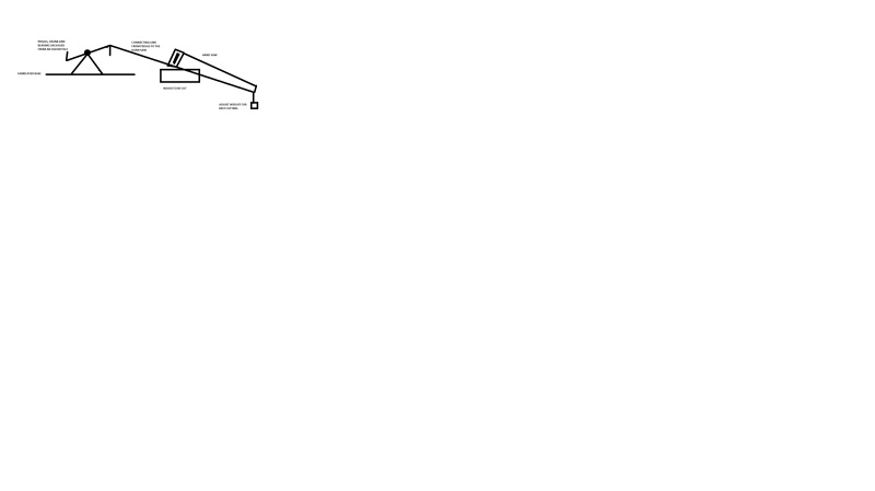

The most entertaining & ambitious project I have going right now is what started out as a bicycle powered table saw. After some development, a more accurate description for it would be a bicycle powered sawmill. It is worth mentioning that this contraption will only be mechanically powered, no electricity involved.
I snagged a couple boxes of random metal from an estate auction (needed the hand plane blade) for $8. Among my haul was well over a dozen pulley wheels of various sizes. This became the first pieces of the puzzle.
Here is a (very) rough sketch of of the drive train.
The scribble in the top left is me trying to keep track of the various pulleys.
Here is a rough sketch of the intended table bracing members, meant to secure the workpiece. Along with what I call a "mule": pulls the workpiece across the table.
Obviously, there is more to this. But I am currently between 12hr shifts, and my phone needs to charge while I recharge.

Handheld standard 7 1/4" saws pull 13 amps. I believe that's in the neighborhood of 2hp.
If you're actually looking to build a sawmill to process logs, you need a whole lot more power. See http://www.sawdesigner.com/powcalc.php.

Interesting question.
Would you run a table saw on a 1/4 hp motor? That's supposedly the most an average person can sustain for any length of time. There is a reason that pre-steam era wood cutters used two-man pit saws or water power.
Would a band saw would work better with your limited power budget? The circular saw blade will be pushing back against your feed mechanism.

With sharp blades, the power used by a saw is closely related to the amount of wood being removed. A very thin kerf band saw uses much less power than a thicker circular saw.

The numbers quoted are for standard circular saw blades, which are on the order of 1/8th inch thick. Any thinner, the blade potentially can break or snap, resulting in serious flying metal. You could possibly minimize the power by using a blade with higher teeth count, say, 140, instead of 60, but it'll ostensibly take twice as long, as each revolution is removing less than 1/2 the material.

To answer a few questions and concerns...
Regarding the blade itself:
I have been in contact with a leading saw blade manufacturer that has a real R&D department. The gent who responded to my inquiry gave me some very helpful info.
First, as circular saw blade diameter increases, the minimum RPM required for it to "run true" (see: proper blade tension) decreases.
A larger blade also achieves higher linear feet per minute for every RPM. An antique sawmill blade over 3' across is not a practical option...
Yes, I plan to select a blade with a thin/hollow ground kerf, with a "finishing" tooth count.
Feasibility:
I am well aware that this is not an efficient method for cutting wood. I actually picked up a table saw in another estate auction about a year after conceiving the bikemill, so this isn't even necessary at anymore. Now, I am doing it just to prove I can!
The focus should be less on quantified "power output", and more on linear FPM. Through the multiple pulleys, there will be mass for some energy storage.
The feed-rate will be an important detail. Slow is the goal, because the workpiece will act as a brake (obviously). This will likely incorporate a scotch & yoke mechanism between a pulley and a ratcheting device.
I plan on getting a universal tachometer with halo proximity sensor, to satisfy my statistical curiosity.

Try to think about why you would use a circular saw. Most motors rotate. Most motorized saws take advantage of this. If you think about it, a circular saw has poor leverage around the shaft. Motors have the required torque. Almost all manual saws reciprocate because we humans are efficient moving things back and forth. If I am playing with any circular saw, I want to position the saw, and keep my fingers, any dangling clothing, cats and the power cord out of the saw blade. If you are frantically peddling, you are not focused on where that saw blade is.

Those are fair points, but there are further considerations.
A bicycle is extremely efficient at converting our reciprocal motions into rotation. Plus, that 26" rim is the largest pulley wheel I have at my disposal lol.
Maybe I didn't explain it thoroughly enough, but there will not be anyone within reach of the saw blade while it is active! That is why I said a more accurate description would be a bicycle powered sawmill. Fences, guides, braces, winches: adjustable and lockable.
Oh, and as part of the "added challenge, just for kicks!", I am using as many off the shelf parts, or scrounging materials, as possible. A ten foot linear reciprocating saw blade that might have been used in an even older sawmill would be even more difficult to acquire... 14" circular saw blades? Not so much.

Two fast a feed rate and the gullets will be overloaded and friction losses will increase and efficiency will drop. The saw blade may be damaged by high friction generated heat.
This won't happen with manual power.
With a manually powered saw you are going to be severely power limited.
I suggest that with a given amount of power, there will be the same maximum feed rate, regardless of the saw speed.
I doubt that you will reach the gullet capacity limit until the RPM drops into the double digits and possibly the single digits.
Why loose precious power with belt losses and at higher speeds, windage losses.
Try a couple of very slow saw speeds. I believe that you will find the maximum allowable feed rate to be largely independent of the saw speed.
Forget gearing up the saw speed. Run the saw very slowly. You may well find a sweet spot between saw speed and feed rate but I suspect that it will be at a very slow saw speed.
Bill
"Why not the best?"
Jimmy Carter

Well, you say that this has been done before, and we have no reason to doubt that, but the results of those efforts can only be accurately described as "wood was cut".
Much good info has been given by others pertaining to aspects of blades and cutting with toothed blades, but this is hardly a complete and accurate description of the action and power requirements of toothed blades for cutting woods. You haven't clearly defined the cuts you will attempt, or set any limits, except human power and torsional delivery of that power.
Therefore, I can reasonably recommend your construction or adaptation of a mill using a band blade, because of the far greater energy efficiency afforded by superior friction characteristics and tooth efficacy. Since you haven't placed minimum or maximum workpiece dimensions, I'll select a range of 0-0.750" workpiece thickness, and you can determine the maximum distance from edge for your cuts by your selection of blade length. Your blade must have 4TPI, OR varied to obtain no more than 4 or less than 3 teeth in the workpiece. Your feedrate will be less than the 1/8" per foot of blade motion.
It'll work just fine. Now just build it!

At the end of the day this arrangement will probably give the best efficiency, smoothest action and fastest cutting.
No energy is lost in gearing or belting.
Normally a hand saw is used with one hand. This will allow the other hand to help also by pulling on the offside pedal.
Bill
"Why not the best?"
Jimmy Carter
RE: "Easy Way Out" Is No Fun At All!!
Without getting into vast detail I tend to agree with the last two.
Basically this revolves around Power ( or lack therof) and how you apply that power.
A human powering a cycle can get to around 150W max for relatively short durations.
My 7" electric saw has a motor power of 10 times that, so even assuming near perfect speed increases, you're looking at an effective cutting power of less than a 10th for a person.
Only if you power up a flywheel using some kind of geared system could you get an short term increase in available power - the most efficient number of RPM for the human leg is around 80-90 rpm so a geared system would be best to continuously increase speed and hence energy in the flywheel. Seems far too much bother for the benefit to me.
Alternatively turn cyclical motion back into reciprocal motion or use some sort of pulley arrangement to pull a saw back and forth using your legs in motion.
