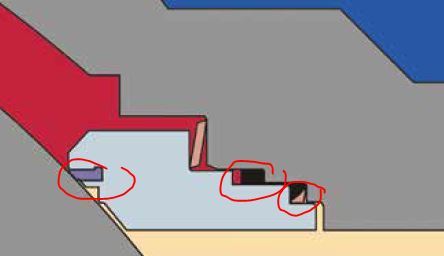

What is the design look like? Not to generalize the concept of ball valve, however most of medium to big size floaters with soft sealing looks like below
Behind the seat usually designed with two extra sealing with either o-ring and or PTFE.
To provide effective sealing, the grove dimension (including the OD of the seat) of the extra sealing behind the seat should be appropriate.

If this is without any cycle test, without any secondary sealing design, my suspicion would be indeed there is a seat design issue including dimension and tolerance. Not necessarily only the OD.

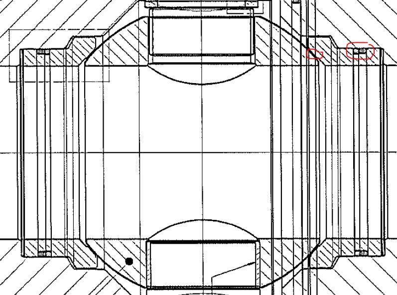

Thanks Danlap for your detailed answer. unfortunately in my case we don't have the luxury not to test the seats, we test the seats 100% to min 814 psi for #300 for the min duration as per 6D. as you see here in the drawing, this design is very simple just the seat in the seat pocket. (no secondary sealing design)
the seat comes in already distorted from the supplier the OD is undersized and egg shaped. i believe the residual stress in the material from machining cause the distortion. therefore we looking into the option of stress relieving of semi finished seat then do final machining after the heat treatment. or using a mandrill to hold the ID.
i think the main issue here is the thickness of the seat and the corresponding pre-compression, i am not sure how to achieve this optimum pre-compression to avoid the leaking of the seats, i thought about making the seats thicker then keep skimming of the bottom of the seats few thou at a time until reaching the targeted thickness.

First of all, I have to say I am quite impressed that this design (without Seat holder), this size and assuming this is the manufacturer prototype capable to pass the test up to 800 Psi.
Did you ever thought to change the material with the one that is less prone for distortion e.g. PEEK or others?
If your egg shaped judgement prior used is correct, then yes you may limit the risk of machining faults by the method you've mention above. This is quite experimental since I am not sure how does the pressure and the weight of the ball (assuming the valve tested vertical) resulting the downstream's (supposed to seal) Seat expand against the seat pocket accordingly.
Plus this is also a very thick PTFE Seat

Hi Danlap, the seat pressure test is done vertically on a test stand. so it's not the weight of the ball. i think because the gap between the seat and the seat pocket will create a leak pass from behind the seat ? so if i have a snug fit between the seat OD and the pocket ID will eliminate this leak pass ?? is there a calc sheet out there for floater ball valves? i would like to perform seat calculations. i would like to perform a FEA simulation as well maybe i will have to re-design the seats. is there anyone have experience on seat re-design or simulation?
RE: Another issue i am having with floater ball valves is the valve keep failing the seat leak test
issue resolved and lesson learned
i just increased the height of the seat and increased the (pre-compression/squeeze/crush ) from .45 mm per seat to 1.45 mm
