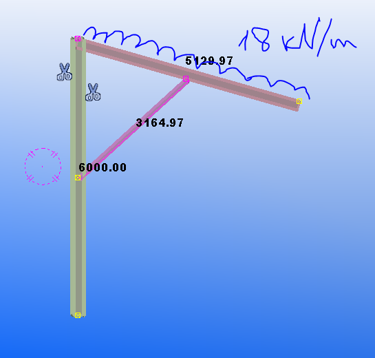

Cant seem to figure out exactly what loads are acting on steel column and how to design it.
Does the column have two loads acting on it? Axial load from top (which is used to check Compression and Buckling) but what happens with point load from diagonal bar?

the column takes like a beam, cantilevered at the base
RE: What are exact loads on column?
The axial load on the lower column is 18*5.13 = 92.3 kN
If the diagonal intersects the beam at midpoint, the axial load on the upper column is zero, otherwise it could be in tension or compression.
The moment in the lower column is constant: M = 92.3*5.13/2 = 237 kN-m from top to bottom.
The moment in the upper column varies from 0 at the top to 237 kN-m at the bottom.
The horizontal force in the upper beam and diagonal strut is M/h where M is the moment in the lower column and h is the height of the upper column.

That aside, this looks like a homework problem. An engineer (even one just graduated) should know how to do a free body diagram.
The assumption was made above that the base is a fixed (momented) connection. Is that true or did the rest of the beam get cut for the sake of the upload? If it is fixed, the worst-case condition for the column occurs below the brace connection and you don't need to know anything about the beam or brace to design the column. Designing the connection of the brace and beam to column is a different story though. The amount of axial load the brace takes is a function of its stiffness which is probably outside your comfort zone based on the question. I'm not trying to sound mean, but part of being an engineer are the assumptions you make.

That is a Tekla screenshot, and the sig figs of the software is set to two decimal places. He has used the dimensioning tool within tekla to create the sketch posted. It is not uncommon when modelling to use two sig figs to avoid incorrect part numbering. I do not recall if Tekla offers a school edition, but if not, that is a $20k+ software package. It might not be a homework problem. As for the underlying question, yikes.

and the upper vertical segment is 1854mm long (or 1854.15mm if you prefer) (assuming the diagonal is to the middle of the horizontal)
or it could be 2238mm if at 45deg
or ...
