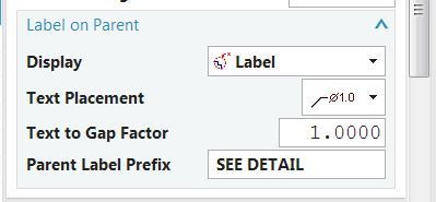

Hello, I inherited a drawing that I'm now attempting to modify. I have two views that are side by side and I have two detail views off of those original views. One of those detail views shows a dashed line for a boundary, but the other detail view does not have the boundary line displayed (even though it shows as dashed in the settings). I even deleted the detail view and re-added it, but the dashed boundary still does not show up. All layers are also on, so everything is displayed. Can someone please help and give a recommended fix so that both views act consistently and show the boundary lines? Thanks

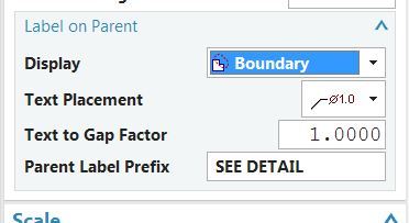

I also have the same situation like OP. It seems when choose display under Label on Parent to "Boundary", the boundary lines won't show on the Detailed View. If choose "Label", the circular boundary line will show.

Hello Bwsh, I double-checked the value for Display and it's already set to Label, but the circular boundary isn't showing. I'm not sure what the problem is. Can drawings just be corrupted sometimes and just have unexplained results? I'm used to using different CAD softwares, so not used to "simple" problems being so time consuming to try and figure out. Any help is appreciated. Thanks

Label on Parent (View)
Those are settings for how the detail is shown out on the PARENT, not the actual view boundary of the detail view itself. OP says, "One of those detail views shows a dashed line for a boundary....," hence why I am pointing that out....the parent is the view from which the detail is taken, not the detail view.
