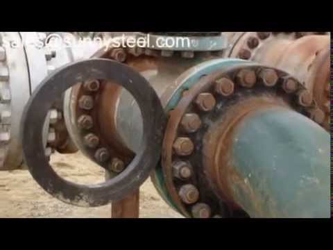

Only thing to add to an excellent post by pennpiper is that you can buy spectacle blinds which are designed to have ONE bolt hole permanently engaged ( usually one of the top or side ones, so that once you remove all the other bolts and separate the flanges, you can swing the blind / spacer around with ease and it also give you a very easy way to visually see whether you have a spacer or a blind flange.
They look like this.
