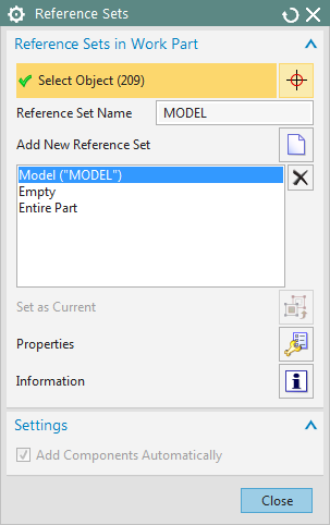

RE: Sheet body in drafting
Switch to modeling in your 3D Item.
Got to;
Menu - Format - Reference sets
From the menu select the Model reference set (All geometry already in there will highlight) and select the sheets to be added.
