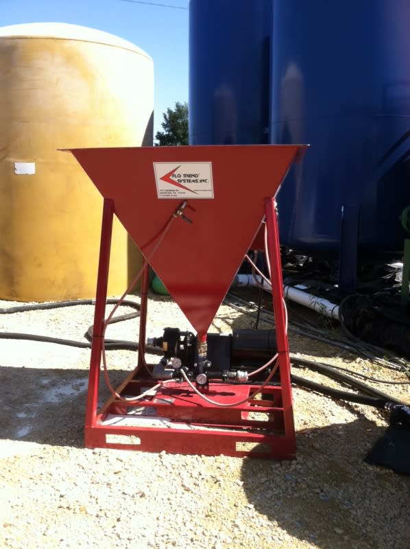

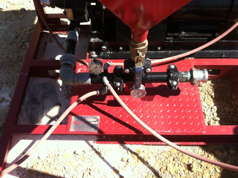

What you have described is a sluicing eductor.
Sluicing Eductor
The operating results will be difficult to predict because of the materials that you are handling. You may have material clumping, bridging, different volumes of sluicing water, effects due to shape of hopper, etc.
Performance chart is listed here:
Performance Chart
Here is a picture of an eductor that was used on a recent project. These eductors are used to sluice media in order to load water treatment vessels with media. This eductor includes a pump to add water pressure.
