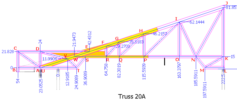

Shown below is an image of the truss that spans 4 walls. The 2 interior supports were evaluated 2 different ways. Initially the interior supports were set as pinned connections and after running an evaluation of the truss the results indicated that these supports produced horizontal forces of 1000 lbs each which pointed toward the center of the truss. The second method considered the 2 interior supports as roller supports which produced deflections of 1/8” toward the center of the truss.
The cap plate is 2” x 4” Grade 2 S. Pine, the trusses are set 24” OC and the longest laterally unsupported wall is 14’. A deflection of 1/8 in the cap plate seems unacceptable and subject to creating cracks in the ceiling. The 1000 lb. lateral load set 24” OC greatly exceeds the capacity of the cap plate.

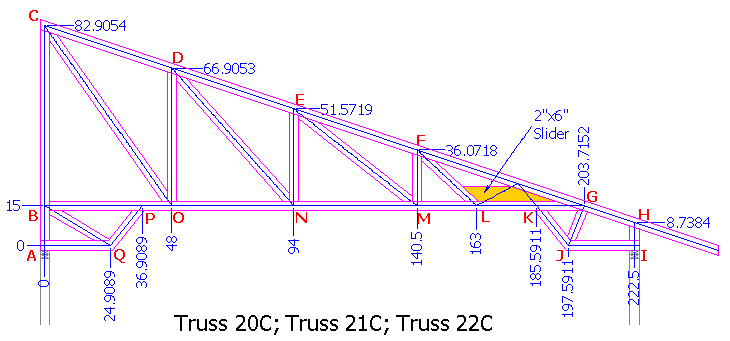

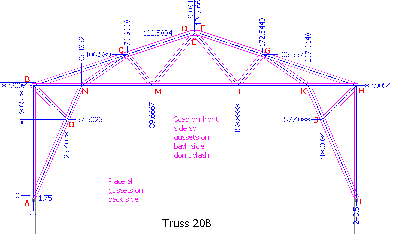

Quite correct, hokie66, quite correct. The cap plate is a double 2x4 and the initial truss image was a composite of 3 trusses as shown below.

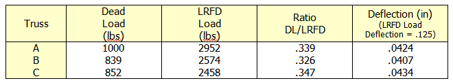

Also quite correct JAE, the deflections from dead load appear to only be around 1/3 of total LRFD load deflection. See table. The deflections were assumed to be linear/load.
So in a worst case scenario it appears there would be a .0838 deflection (or around one and a half 16th of an inch) that hopefully would close when the live load dissipated.

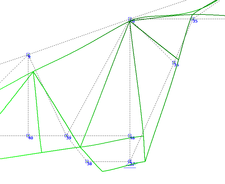

Oh, I quite agree dnlv, (ASD) is most commonly used in serviceability limit analysis for deflection, vibration, clearances, etc. However, I selected strength based limits (LRFD) for the truss design and of course ASD and LRFD methods should not be mixed. Anyway, the frame analysis application also provided displacements which I chose to consider because it was expected to produce the worst case displacements. Shown below is a close-up of the composite truss displacement at the interior wall.
When each truss was analyzed separately the right side of 20A truss displaced to the right and the left side of 20B displaced to the left. However, when analyzed collectively the net displacement was to the right. Now, the vertical displacement of truss 20A over its full horizontal length is ¼”; however, this is spread over 20’ and is not expected to create cracking in the sheetrock. On the other hand the horizontal displacement at the interior wall may cause a discontinuity displacement adequate to create cracks and that was the concern.
Perhaps anchoring the trusses to the cap-plate of the interior wall will force the interior wall to move with the truss deflection (1/8” over 14’) thus eliminating the potential discontinuity and subsequent cracking. The calculated 1000 lb horizontal force for a pinned support at the wall would dissipate (be absorbed by the truss) as the cap plate deflected. However, this concept would only be applicable to a portion of the center section of the 14’ wall; and, as consideration of the trusses moved closer to the laterally supported ends of the wall the calculated 1000 lb horizontal force on the cap plate would become a concern and subject to reinforcement.
