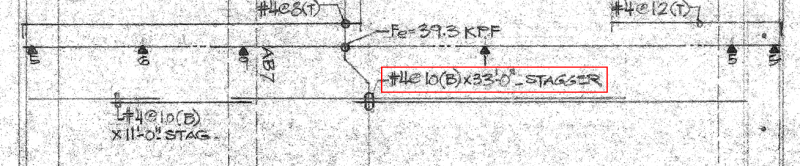

I have a project where we are about to commence an investigation of an UNbonded PT roof slab (corrosion damage, failure of tendons, etc.) constructed in late 1970's - designed by T.Y. Lin's office - and the original structural drawings show the following bottom rebar tag:
Do you interpret the above to mean at MIDSPAN region:
OPTION (A): There is 2#4 every 10" (As=0.40 in2/10") so equivalent to #4@5";
OR:
OPTION (B): There is 1#4 every 10" (As=0.20 in2/10").
We will be checking definitively when the field work commences, just doing some prelim checking to see where the slabs are, capacity wise. Damn, those old designs stretched the limits - 40' endspan with 10" slab ==> L/D=48!

(B), but because the 'bubble' includes both, there is a remote possibility that (A) was intended. Get a rebar locator or a good stud finder that works with concrete and confirm at mid span.

I'm going to respectfully disagree. To me it appears to be a two span condition with the longer span on the right. The two staggered 33' bars (staggered left and right in longer span) would result with 2 bars at midspan.

This is not exactly how I would use the term "staggered" in rebar layout. I would expect staggered to mean that two adjacent conditions are not similar (i.e. the staggering of laps so that they don't line up).
It looks to me like you would have 2#4s 33' long and 2#4s 11' long, with these four bars set every 10" c/c. There would be two bars in the +or- 20' long section where the 33'-0" long bars overlap.

My vote is (B), #4@10 at midspan based on drawings I have seen that use similar convention. Other clues:
1. P/A in the slab relatively high at 328 psi--high enough that the design likely did not require #4@5 at midspan.
2. Top steel at interior support is #4@8 where moment demand is greater than at midspan.

I was OPTION (B) (without hesitation) until I reviewed the calcs of another engineer who did some checking of the slab capacities a few years ago, including assumed % loss of section to rebar due to corrosion and he/she interpretted the bottom rebar as OPTION (A).
We shall be GPR scanning the slabs and undertaking invasive probing soon, so I will get definitive info on what was built.
DEKER - your 'other clues' are well thought out and logical - thank you. Somewhat interesting is that one section of the slab near a ramp termination (40' single span, 10" thick) has 72.6 k/ft (600 psi of P/A) with same bottom rebar - needless to say the slabs have significant restraint and flexural cracking - and no waterproofing membrane was ever applied.

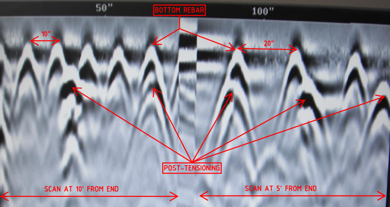

7/31/2017 ==> FOLLOW-UP:
I did some GPR scanning to the soffit of the slab today and can 99.9% confirm that OPTION (B) is what was constructed.
Photo of scan results below. The scanning was done 'inverted' so the bottom rebar is shown on the top of the screen shot. Scan location was each side of where the 33' long rebar stops and staggers - so about 7' from end. 10" and 20" spacing conforms the OPTION (B).
We will be 100% definitive when we start invasive probing mid-August.

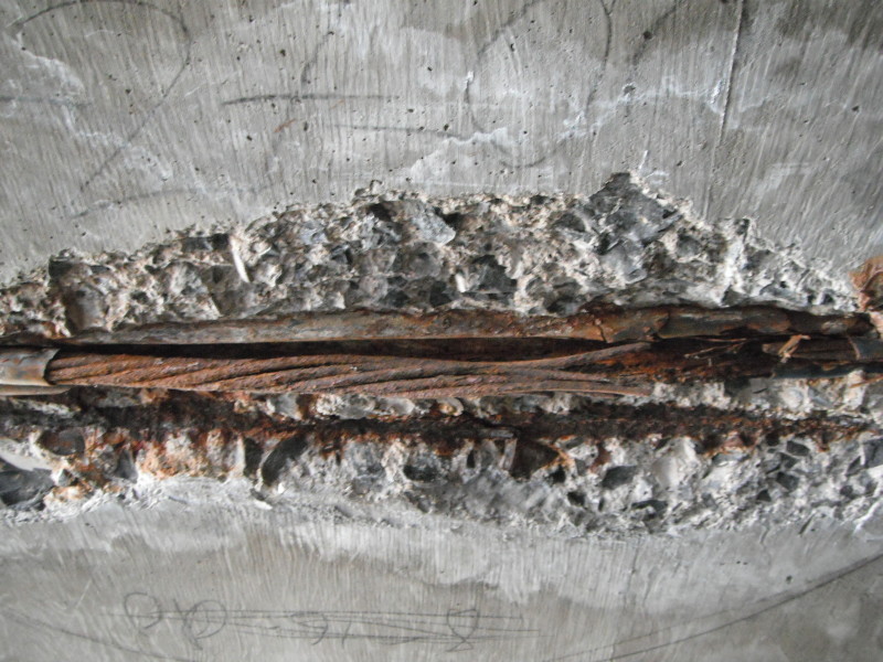

It may be a challenging project with a few corroded and failed tendons clearly evident:

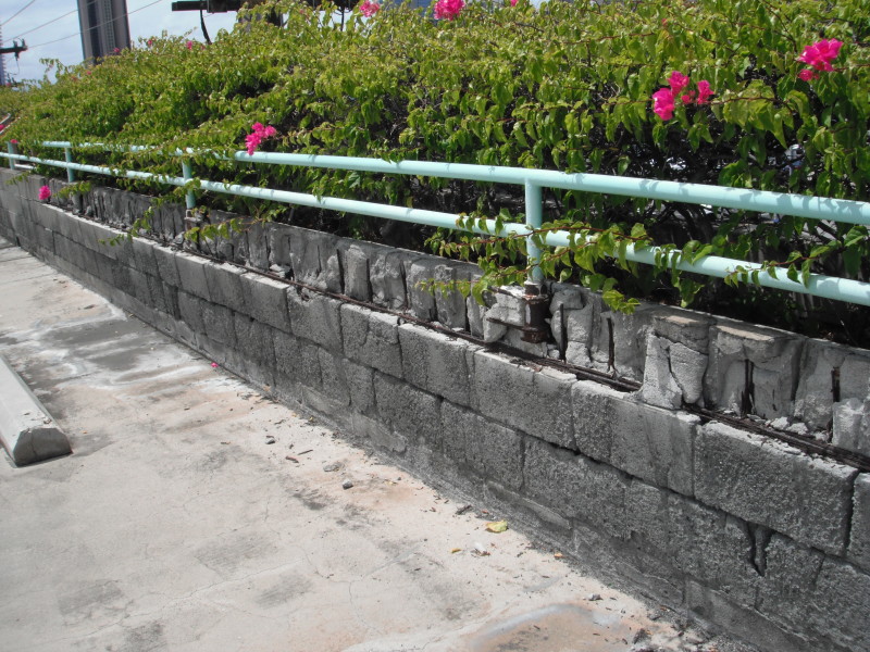

And it is never good to have PT anchorage zones with an non-encapsulated system below planter boxes that have CMU block that looks like this:
EDIT: The two photos above of the PT tendons are soffit photos @ midspan.

Those planter boxes... yikes.

For this structure, I suspect that the near 40 years of water damage will have resulted in significant pitting (with loss of section) and broken wires that strand removal and replacement is probable.

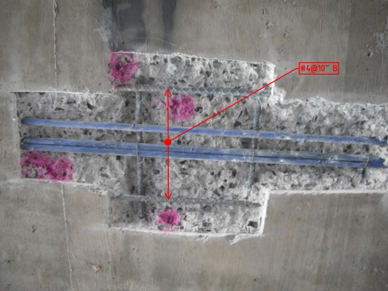

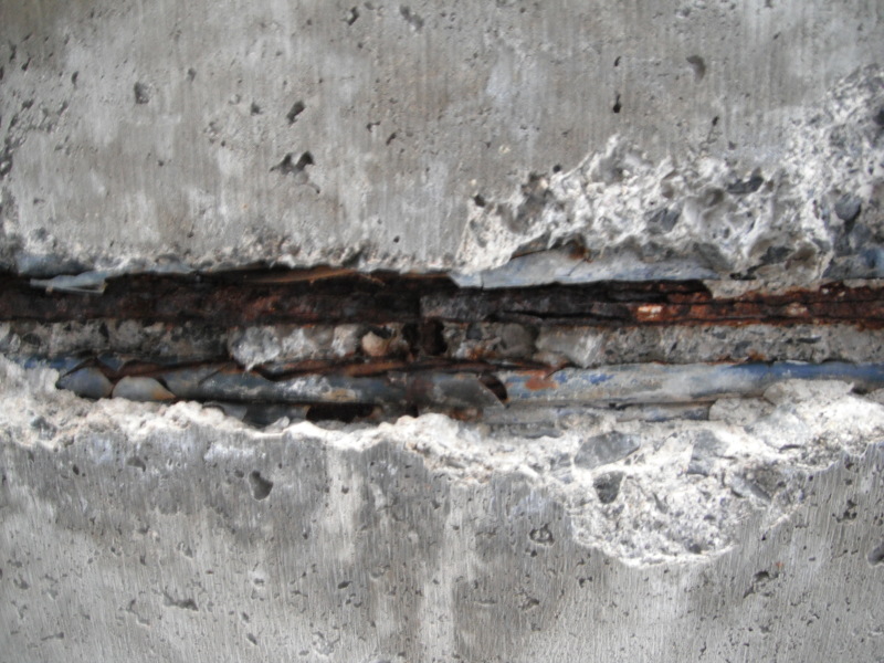

8/15/2017 ==> FOLLOW-UP:
We commenced field work to this project today and have 100% confirmation that 'as-built' was indeed OPTION (B): 1#4 every 10"
RE: Interpretation of bottom rebar tag: "#4@10"(B)x33'0" -STAGGER"
The concrete is cleanly chipped out, and those particular rebars look pretty good. (Can't tell about the others of coourse).
Can you add more concrete below the damaged areas to recover strength?
Can the damaged tendons be pulled out, pulling replacement new tendons back into the old holes? Obviously, the old holes would need cleaning and drying.
