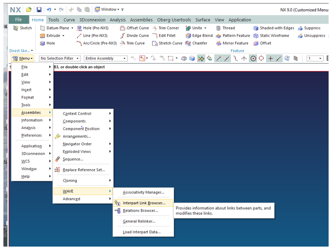

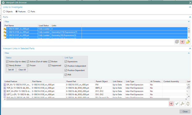

If you have an advanced assembly license you can find the link data of your assembly in the interpart link browser. You can find it here.
This is what the results will look like.
RE: Performance Options - Load Options
You need a "Wave" license rather than a Advanced Assemblies for that report.
I do not know if it adds anything to the "report problem" that Vegetagaru reported.
