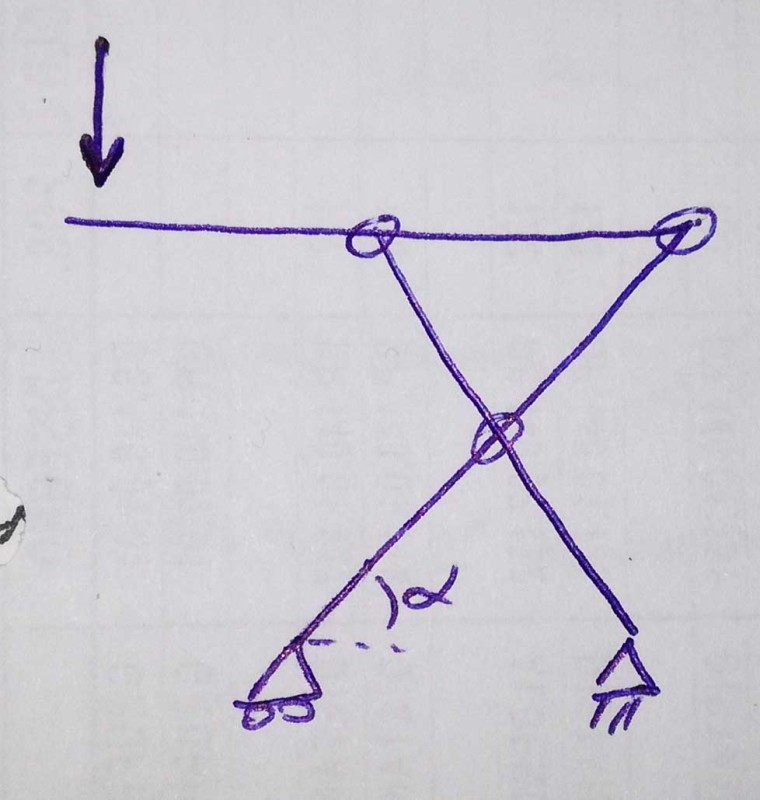

this is a scissor lift, yes. The point is that at university we never studied this kind of structure. only single beam.
in the upper part i think this is a better scheme:
There is a ball screw who governs the extension in the lower support at left.

gtsolid, In your original post you asked for help with the reactions in the upper member. Then you said that you have only studied reactions in single beams. I think your professor is teaching you a very valuable lesson - how to see applications for what you know in the real world. He confused you by adding a lot of extra information you don't need. (They love to do that to teach you to look for what you need to know and ignore the rest.) The upper member is a single beam, supported at two points and loaded at a third. The rest of the picture makes no difference. If the upper beam and all its support points and its load are all defined, you've got all you need.

I have 18 dof, this because i have 3 beams, each with 6dof.
Every simple joint removes 2 dof (2n-1 where n is the number of beam linked by the joint).
In the bottom parte i have a pin support in the right, removing 2 dof, and a roller in the left side, so another dof is going away. How can i remove the others?
i would to find the force i have to apply in the roller to keep the structure stopped

The pinned joint on top next to your load, must slide, for a scissor lift to work.
Your frame now is statically determinate, and easily solved. Your three frame pieces are cantilever beams, also, easily solved.

ok, sounds less like school work, and the sketch is better.
first, there are lots of threads on scissor lifts, try reading them to get ideas.
second, review free body diagrams, then see how to apply them to the problem. some clues ...
1) break the problem into three pieces, the three different members; as well as looking at the structure completely as a free body (ie what ground reactions will react the applied load).
2) consider the top beam. one (the RH one) joint is almost certainly hard located (fixed in position, at the end of the beam) but the LH will slide along the beam. this is not quite as you've shown. this has implications for the reactions on the LH support.
3) the top beam will solve without moments at the supports. It is hard to see how a practical structure would have moments (I'd expect to see pins at these locations).
4) then consider each arm as a free body. Start with the one with the actuator load applied. You have to determine the load at the middle joint, that passes from one inclined member to the other. I think you know the other loads on this member.
third, an important detail ... you mention the actuator, Does it attach to the opposite leg or to the ground ? If the ground, the problem just became indeterminate again (maybe) ! Though you may be able to figure the actuator load from the work done.

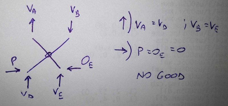

Solving the upper beam i obtain this:
but the result is not consistent. How can i take into account the central pin?
RE: How to study this structure
where is the actuator load ? without the actuator you don't have a structure. what's holding the inclined members at their angle ? you can build a model of this and see for yourself.
Why is the solution "no good" ? Does this mean the two members as individuals don't balance ? because you haven't included the load transferred between them at the pivot. and because you don't have the actuator force keeping the inclined members in position.
Your solution assumes that the inclined members pivot about their mid-point, which may be correct but doesn't have to be.
In your top diagram, the top pin to the left will have to be a horizontal slide/roller connection to allow the "X" to translate laterally at the top.
Otherwise the scissor effect will not work.
Also, "P" will have to have a non-zero value, otherwise no lifting will occur.

"P" is the force that statically hold the frame fixed, so it is the actuator. it is the unknown
gtsolid,
Go back and visualize your structure, then draw a free body diagram. As rb1957 notes, your actuator is part of your structure. Include it in your diagram. If the forces on your two "X" beams are not directly in line with the beams, then you have to analyze for bending. This should not (significantly) affect the forces from your statics analysis.
