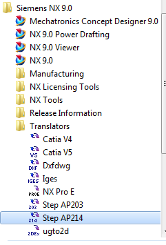

Instead of importing it Using NX, you might be faster using the "External" Translators. You can find them in your installation folder (start menu)

I would "batch" translate them as Ronald suggested. You'll have to set the variables manually to your Java folder.
do a small batch 1st and make sure you are getting the results you want, adjust settings as needed and then do the rest overnight.
