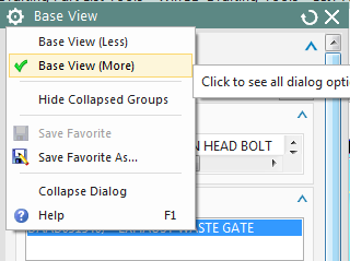

Is there any fast way to add view from the list of loaded parts? I don't understand why its changed in NX10, but now if you want to add base view, it is not automatically selected active part, you must choose from loaded parts:
As you can see, its quite complicated to find the part you need (though you working with it in modeling). You must scroll across full list, until you find the part you need.

Select the gearwheel on the topleft and select more....

so it is already with option "more" in my screenshot. If i choose "less", the list of loaded parts disappears, and it is not possible to add base view at all.

When you click the gearwheel, is there a "show collapsed groups" option? If so, click on it to show groups that have previously been hidden.

I can see all collapsed groups. The problem is how to select proper part from the list? I have loaded more the 100 components (with assembly), and it is difficult to find proper component from the list. I dont understand, why NX does not offer the component you are working with?
