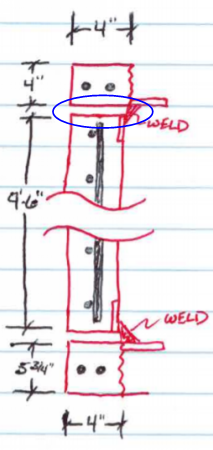

I have a 4" thick, precast wall (~14' long). I want to use the sidewalls of the 10'x14' unit to span piers (0', 7', and 14'). The walls must support the roof distributed loads and the floor distributed loads (applied as point loads at welded connections between floor and walls). One of the 14' sidewalls has a door opening. So my plan was to use the one sidewall as a deep beam and the other sidewall contains shallower beam along the entire length with the depth equal to the portion of the wall above the door (27"). I will consider the solid portions of the wall below this beam to be columns and these wall portions also need to take my floor load to the 27" beam in the function of a tension member. The wall's typical reinforcement is #4 bars at 12" o.c. each way.
So my question is: Are the vertical #4 bars at 12" o.c. considered stirrups and able to be used as my shear reinforcement? I always thought that the shear bars needed to enclose the longitudinal reinforcement with some kind of hook, but from reading the definition in ACI 318-14, a stirrup is "reinforcement used to resist shear and torsion forces in a member; typically deformed bars, deformed wires, or welded wire reinforcement either single leg or bent into L, U, or rectangular shapes and located perpendicular to, or at an angle to, longitudinal reinforcement.
I am having trouble showing the 27" deep, 4" wide beam to satisfy shear requirements without shear reinforcement (i.e. Vc>ΦVn). I shouldn't have a problem though if I can use the #4 vertical bars in my Vs.

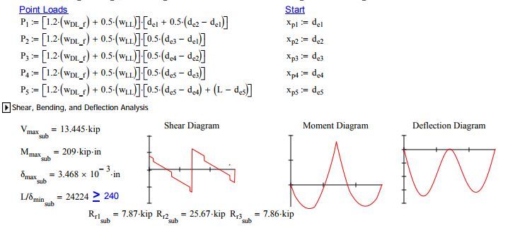

I don't have any software that would do the analysis for me (I don't think RISA-3D will), so I did the analysis in MathCAD with conservative assumptions I believe. Take a look at the attached calculation if anyone would like to review it and give me their thoughts. I also provide a W-beam alternative to the deep beam at the end of the calculation that I wish they would have been good with, but they didn't want the beams. I do pride myself on nice formatting and flow of calculations (maybe not 100% to my standards on this one), but hopefully they are easy to review.

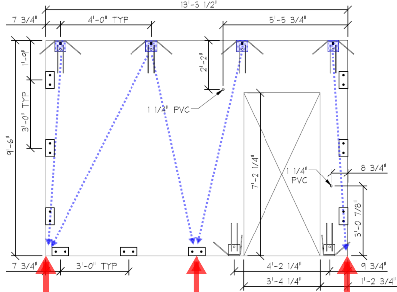

If you have the wall globally supported by 3 piers (RED arrows at 7' c/c) and the floor loads 'dump' their loadings via 4x cast-in 'patch' connections (BLUE color) then these forces are going to 'flow' something like this, which will be in keeping with what BA stated above (I think):

It seems the 'patch' connections are arbitrary points in that diagram for the load lines. Maybe you will agree if I tell you the roof sits on top of the wall so it is continuously bearing on the wall (i.e. it is not hung on the inside of the wall with a welded connection). Also you say the floor dumps its loads into the wall via the 4x patch connectors, but the floor loads the wall through a tensile force in the 5x patch connectors (I am making them change them all) at the base of the wall. Regardless, I think that diagram would be a fine truss model. You say strut and tie and concrete is the weakest of my materials knowledge, so perhaps "truss" = "strut and tie"?
hokie,
I think I follow you. My analysis turned into a beam with a hole in the web instead of an actual truss design. Ingenuity's drawing would be closer to the truss design you are intending and I might've done, but it seemed the beam analysis was easier for me.

Ingenuity: Sorry, I should have been clear in that detail. I was just showing the separate pieces (top chord, web, bottom chord) and that a connection is used to transfer the longitudinal shear of a composite action beam. In reality, there is no separation between the pieces. Everything is in complete bearing before getting welded up.

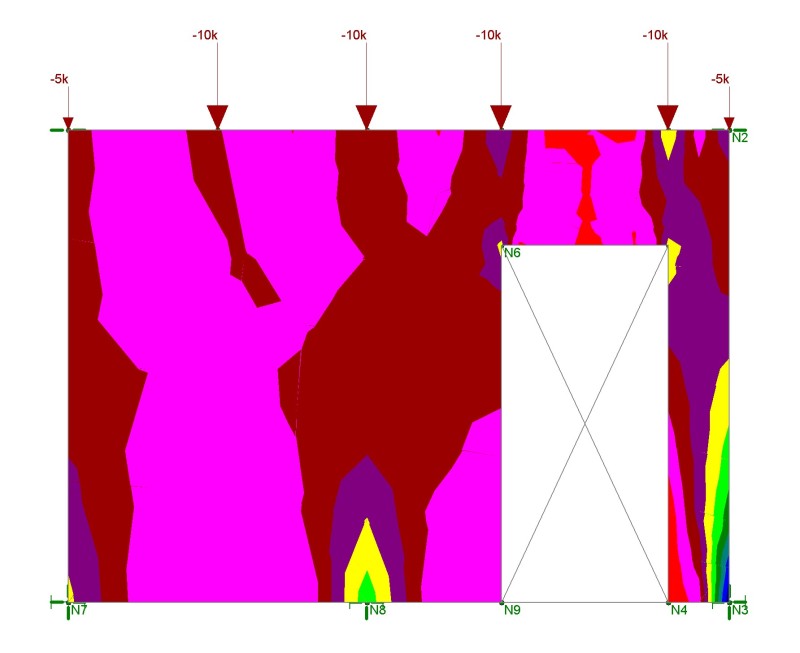

RISA-3D (aka 'RY ZA' for you smile) would make 'light work' out of this panel:

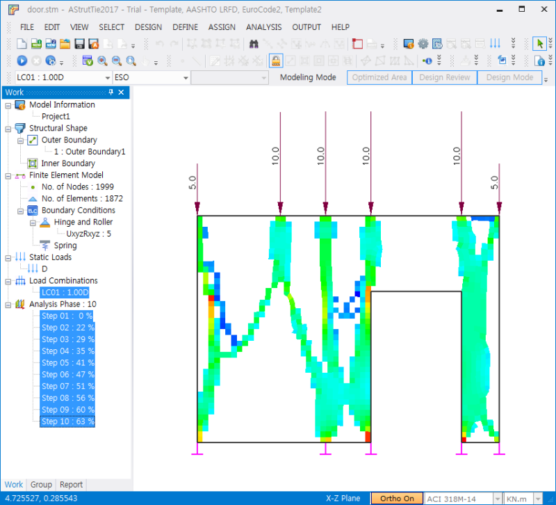

The stress flow is clearly visible. As the stresses flow in the vertical direction, horizontal reinforcement should be placed.

Did you do a wall panel or plate elements? I don't know how to take the stresses/forces and correlate that to reinforcement.

Thank you. I wrote this one myself and, sorry, I don't want to part with it. I consider it proprietary as I think it gives me an advantage. Also, if you expanded the collapsed area, you might just get confused! I will tell you that it uses singularity functions. I currently have it so I can define (10) support locations, (10) point loads, (10) distributed loads, and (10) ramp loads (drifted snow). I can increase that in the future if there ever is a need. I also have not had the need for applied moments, but I guess I could also include those. Each support location has a boundary condition associated with it so that I can do simple supports, fixed ends, or single supports. To get the graphs, I step along the beam in some interval (usually an inch divided by some tolerance factor [2=1/2", 4=1/4", etc.]) to keep the graphs smooth. The problem is keeping the vectors of the shear, moment, and deflections eats up a lot of size. I dump everything else to keep the size down, but I can easily get to 30 MB file sizes on a full system calculation.
Lim,
Thanks for the effort. Looks similar to Ingenuity's stresses in his last post. With my reinforcement, it looks like I have a capacity of 13.16 kip/ft when I consider the concrete and shear reinforcement.

Wall panels. If you assign Wall Design Rules in RISA-3D it can 'design/check' your panel using the Wall Panel Editor. Info here: Link
