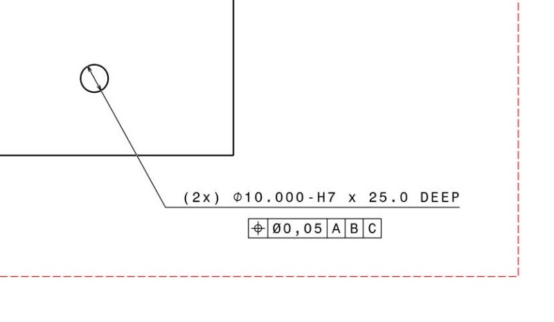

Could someone point me too the commands to alter the contents of the Datum & GD&T boxes on 2D drawings with a macro? I would like to have pre-defined ones but can't find the commands in the automation file.
Could someone also give me a poke on how to create a dimension with a macro, any will do just so I get the idea?

My thinking is that I can drop a Tolerance box on the drawing then run a script to fill in the details.
I'm using the same idea for different hole details which is making the drawing quicker to complete and a lot more consistent.
I have attached a jpeg showing what I mean.

Alan, I'm really a lazy guy when we talk about boring tasks, that's why I like programming bigsmile (I'm not a professional programmer by the way).
You can delete on that drawing everything, save with another name and let just what you captured in the jpg file. Is interesting what you are trying to do and maybe someone can test different things on that drawing. You will not find so easy peoples willing to recreate your problem.

I have managed (with the help of yourself and the other guys here) to do most of the dimension annotations that I need.
I've found even simple scripts that create text boxes with predefined text inside make creating drawings much faster with zero spelling mistakes.
Things like "TYPICAL 2-PLACES" or "C/SINK TO SUIT M6 SCREW" cuts down on the mouse clicks :)
There is other stuff I would like to do but that will take a lot more learning on my part.
With the tolerance box I just need pointing in the direction of the commands in the automation file.
There doesn't seem to be any reference to it but I could be looking in the wrong places.
